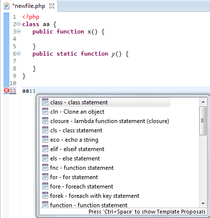

I've just upgraded to Kepler with the following procedure:
- Added http://download.eclipse.org/releases/kepler to the "Available software sites"
- Menu Help - Check for updates
- Updated and restarted Eclipse
Now the content assist stopped working, both for existing project and for a simple php file like the one you can see in the attached picture.
What can I do?
Michele
