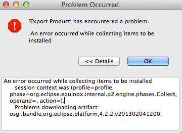

Dear all,
i'm trying to export a product using the wizard but I always get this error:
index.php/fa/14760/0/
I installed gmf/emf whatever, I added org.eclipse.platform plugin (or
fragment) to the workspace; the export starts and runs but it ends up to
this point and I don't know what to do next.
How can I fix this issue? As you can see from the picture, I'm running
Eclipse on the Mac (10.8.3).
Thank you

I was able to fix this by unchecking "Generate metadata repository" option in the export wizard form.
Not sure why this won't work, if somebody has a clue it would be very much appreciated.

from the attached product definition, one major problem is that you are trying to export your product with a mix of different platform-specifc plugins (linux, win, mac, x86 & 64).
You should first reduce the plugins to the platform and window-system, you are tring to build on.
Later on, and if you are targeting multi-platform-builds, you are better setup (I would always suggest to do so) to use feature-projects, where you can explicitely define the target environment for each plugin.
Also it might be a good thing to complete the product settings, such as launcher icons, etc. as this could break the build as well. Use the eclipse-ide things as a test approach and modify this when you got it working to create your own product-branding.
