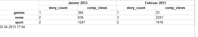

I attached another example (cube_countdistinct_v2.csv) with more stories per category (this is dummy data of course). The expected result is as displayed in the attached cube_countdistinct_v2_result.png .
