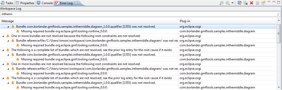

Re: ER like connections [message #1021464 is a reply to message #1021341] Wed, 20 March 2013 02:37 Go to previous messageGo to next message
thanks for the quick respons.
I don't know how to find the log file and metadata, but in the runtime error log i get the followingg message:
missing required bundle org.eclipse.gmf.tooling.runtime_0.0.0.
any help on how to resolve this?
  • Attachment: error log.PNG
    (Size: 50.93KB, Downloaded 335 times)
Re: ER like connections [message #1021471 is a reply to message #1021464] Wed, 20 March 2013 03:06 Go to previous message
problem solved by installing gmf tooling runtime extensions!
