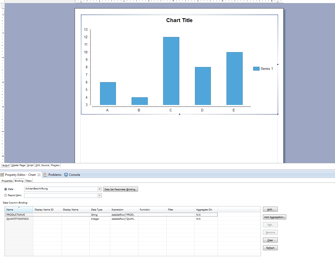

I'm modifying the HTML emitter and want to know if there is any possibility to get the axis description of bar charts. Better would be information about the dataset.
I want to read out the entire Information about charts.
In this class:
org.eclipse.birt.report.engine.emitter.html.HTMLReportEmitter.java
is a method startImage() which receives an image with some informations about the bars but I also need the information about the axis, about the chart type and so on.
How does the startImage() method works and how the method is called?

Re: HTML Emitter - How to get the axis description of the charts [message #1014786 is a reply to message #1013171] Tue, 26 February 2013 08:18 Go to previous messageGo to next message
Hi Jason,
yes, I already checked it and there are just these bindings. Isn't it correct?
index.php/fa/13561/0/
If I delete them I don't get a chart anymore.
Samet

Re: HTML Emitter - How to get the axis description of the charts [message #1015244 is a reply to message #1014786] Wed, 27 February 2013 16:11 Go to previous messageGo to next message
The bindings look ok. Can you print out the column name?
(rsmd.getColumnName(i+1)
Jason
Re: HTML Emitter - How to get the axis description of the charts [message #1015338 is a reply to message #1015244] Thu, 28 February 2013 04:35 Go to previous messageGo to next message
Hi Jason,
this is the print:
18th Century Vintage Horse Carriage
PRODUCTNAME
5992
QUANTITYINSTOCK
5992.0
row[QUANTITYINSTOCK]_Sum

Re: HTML Emitter - How to get the axis description of the charts [message #1016051 is a reply to message #1015338] Mon, 04 March 2013 12:49 Go to previous messageGo to next message
Samet
The last one looks like an aggregation element in the chart. You could just look for the row[... and throw it away.
Jason
Re: HTML Emitter - How to get the axis description of the charts [message #1016761 is a reply to message #1016051] Thu, 07 March 2013 10:45 Go to previous message
Okay, I will do it.
