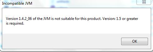

Here is a screenshot of the error:
index.php/fa/13453/0/
I try the tips I found here in the following links. But still didn't work, the statements are not recognized something like that.
http://www.eclipse.org/forums/index.php/m/240461/?srch=incompatible+jvm#msg_240461
http://www.eclipse.org/forums/index.php/m/172791/?srch=incompatible+jvm#msg_172791
We tried to resolve the error by updating the JVM in my friend's laptop. After that still the error appears everytime we launch the eclipse.exe.
We just really need to install eclipse for us to do our project.
Thanks in advanced.

Re: Incompatible JVM at Eclipse installation [message #1010253 is a reply to message #1010152] Sat, 16 February 2013 20:10 Go to previous message
> Thanks in advanced.
This typically happens when you've got more than one JRE on your
computer and the bad (old) one just happens to be found first in your
PATH variable.
Please follow the instructions (referred to in your second link) on this
page:
http://wiki.eclipse.org/Eclipse.ini
