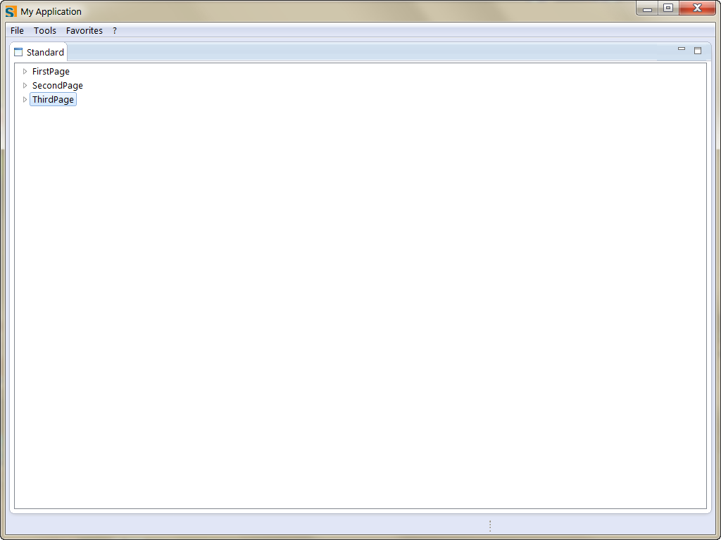

Hello Urs and Jeremie
Let me describe a clean test-bed project for our case With some steps.
Step 1.
Create a new Scout project with "Otline Tree and Table Form" template let's say xx.xx.
Step 2.
Goto ScoutExplorer xx.xx --> client --> Desktop --> StandardOutline --> Child Pages and create three new pages using AbstractPage template with the following names.
  • FirstPage
  • SecondPage
  • ThirdPage
Step 3.
Goto ScoutExplorer xx,xx --> client --> Desktop --> Forms and create five new forms with the following names

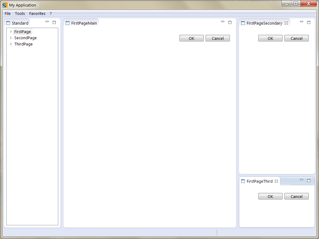

Now goto FirstPage.java and add the following code.
  FirstPageMainForm mainForm;
  FirstPageSecondaryForm secondaryForm;
  FirstPageThirdForm thirdForm;
  protected void execPageActivated() throws ProcessingException {
    mainForm = new FirstPageMainForm();
    mainForm.setDisplayHint(IForm.DISPLAY_HINT_VIEW);
    mainForm.setDisplayViewId(IForm.VIEW_ID_PAGE_TABLE);
    mainForm.startModify();
    secondaryForm = new FirstPageSecondaryForm();
    secondaryForm.setDisplayHint(IForm.DISPLAY_HINT_VIEW);
    secondaryForm.setDisplayViewId(IForm.VIEW_ID_E);
    secondaryForm.startModify();
    thirdForm = new FirstPageThirdForm();
    thirdForm.setDisplayHint(IForm.DISPLAY_HINT_VIEW);
    thirdForm.setDisplayViewId(IForm.VIEW_ID_CENTER);
    thirdForm.startModify();
  protected void execPageDeactivated() throws ProcessingException {
    if (mainForm != null) {
      mainForm.doClose();
      mainForm = null;
    if (secondaryForm != null) {
      secondaryForm.doClose();
      secondaryForm = null;
    if (thirdForm != null) {
      thirdForm.doClose();
      thirdForm = null;
Step 5.

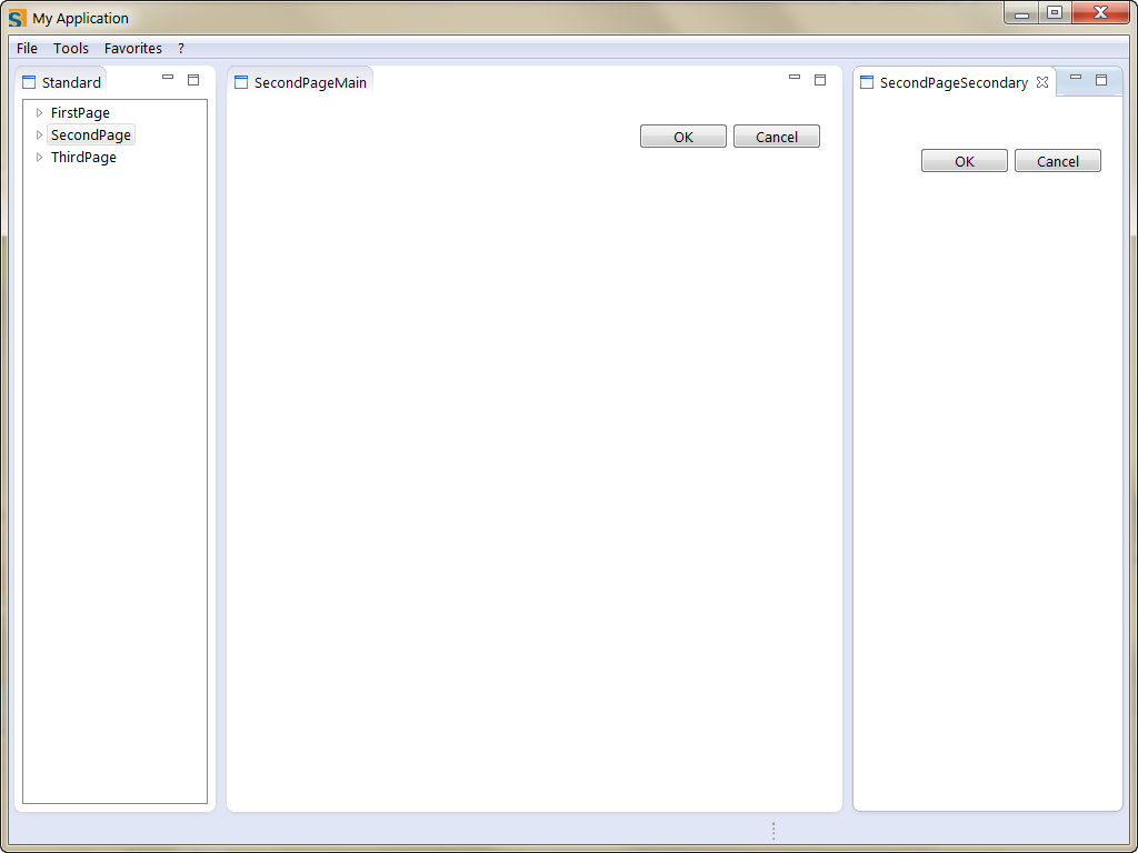

Also goto SecondPage.java and add the following code.
  SecondPageMainForm mainForm;
  SecondPageSecondaryForm secondaryForm;
    mainForm = new SecondPageMainForm();
    secondaryForm = new SecondPageSecondaryForm();
      mainForm.doClose();
      mainForm = null;
Step 6.
