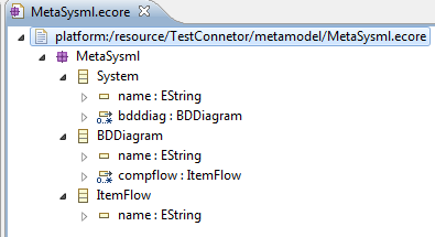

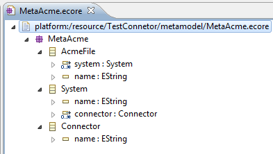

I am trying to do a ATL transformation: SysML2ACME:
 -- @path MetaAcme=/TestConnetor/metamodel/MetaAcme.ecore
-- @path MetaSysml=/TestConnetor/metamodel/MetaSysml.ecore
module SysML1;
create OUT : MetaAcme from IN : MetaSysml;
   rule System2AcmeFile {
	from s: MetaSysml!System
	to
	     t : MetaAcme!AcmeFile (
		    name     <- s.name,
		    system   <- s.bdddiag-> collect(fam | thisModule.Bddiagram2System(fam))
    lazy rule Bddiagram2System {
	from s: MetaSysml!BDDiagram
	to
	     t : MetaAcme!System (
		    name     <- s.name ,
		   connector<- s.compflow->collect(con |thisModule.ItemFlow2Connector(con))
  lazy rule ItemFlow2Connector {
	from s: MetaSysml!ItemFlow
	to
	     t : MetaAcme!Connector (
		    name       <- s.name ,
		instanceOf <- s.assignedto.toString() ,
			Roles      <- s.interfaces -> collect(i|thisModule.Interface2Role(i))
But when I execute the ATL module, I do not get the expected result.
Indeed, it was not the occurrence of connector.
however, both meta-models are been verified, presented below
index.php/fa/20864/0/
I don't understand this error. Someone could help me ?
Thank you.

is there an exception or something which appears on the ATL-Console?
