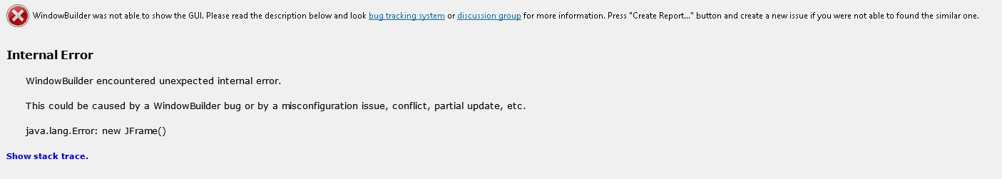

Can anyone help me shed some light on why I am seeing this error? I have used Eclipse WindowBuilder to create a GUI for a Java project. If I start eclipse, and load my project, WindowBuilder works fine and I can see the GUI being displayed, I can add/remove components, and so on. However if I switch to my source code and back to the Designer, I get the error shown in the attached screenshot.
I have attached the Stack Trace for you to look at.
If I click the "Go to Problem" button, it takes me to the source code with the line below highlighted:
private void initialize()
		frmEcg = new JFrame(); <------------- This line is causing the error
		frmEcg.setTitle("ECG");
		frmEcg.setBounds(100, 100, 1239, 904);
		frmEcg.setDefaultCloseOperation(JFrame.EXIT_ON_CLOSE);]
I have to restart eclipse to go back to my GUI. It is frustrating! Any ideas?

Re: Strange WindowBuilder Error! (Internal Error) [message #1616831 is a reply to message #1614935] Sat, 14 February 2015 17:02 Go to previous messageGo to next message
Looks like a know bug in JDK 1.8...
at java.beans.MethodRef.get(Unknown Source)
at java.beans.PropertyDescriptor.getWriteMethod(Unknown Source)
There is a workaround in the latest WB build.
