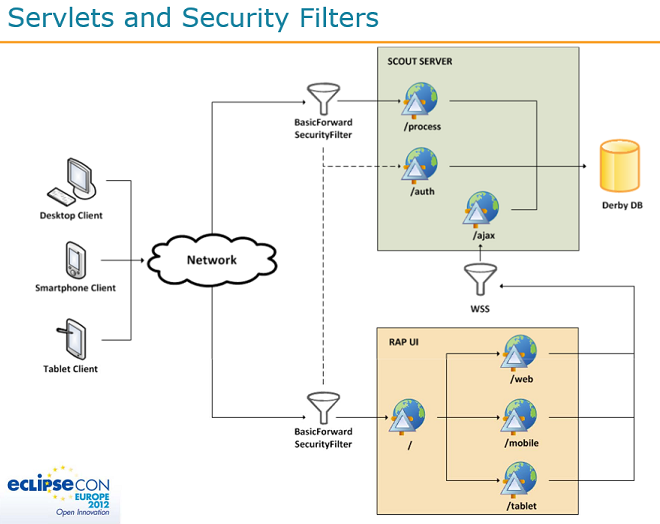

I have asked my coworker what is the state of the art solution of your problem.
In our vision the RAP-Server (aka Scout Client) does not connect to the database.
The solution was presented at the EclipseCon Europe 2012. See the slides: 20121022_BahBah_Slides.pdf
On slide 23 you will see the overview:
index.php/fa/21586/0/
The RAP-Scout-Client has a BasicForwardSecurity filter who will ask the "/auth" servlet on the Scout Server. This servlet is available without any password.
The Server will be responsible to log the user in. This way you have your Database configuration at one single point (the server) and the RAP-Scout-Client knows nothing the Database.
If you do not have a desktop client, you do not need the "/process" servlet in the server.
You can check the Bahbah Chat demo application where this is implemented.

Jeremie Bresson wrote on Fri, 13 February 2015 14:51

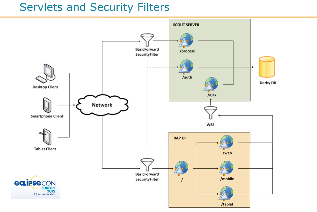

Ok. I think I know what you mean. But I have to look further through the code. But if this is more or less the reference implementation of how to authenticate web users, wouldn't this be worth a wiki entry? Since there only securityfilters are mentioned?
