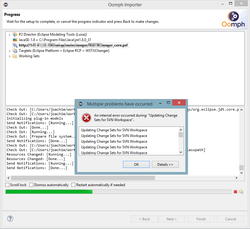

During this outputs an window opened, which is titled "Multiple problems have occurred" and contains a list with endless errors which are named "Updating Change Sets for SVN Workspace". The details say, that there is a java.lang.NullPointerException. Each time I close the dialog with OK, it comes up immediately and it seems, that the list of errors grows up continuously. The memory consumption of eclipse rises up until I get a memory access violation error and eclipse closes. Sometimes the windows explorer restarts as well and I get strange graphic issues.
index.php/fa/20768/0/

Some further information, which I found in the workspace log file:
!ENTRY org.eclipse.core.jobs 4 2 2015-02-09 15:24:03.568
!MESSAGE An internal error occurred during: "Updating Change Sets for SVN Workspace".
!STACK 0
	at org.eclipse.oomph.setup.ui.wizards.ProgressPage$ProgressPageLog.message(ProgressPage.java:1139)
	at org.eclipse.oomph.setup.ui.wizards.ProgressPage$ProgressPageLog.log(ProgressPage.java:1124)
	at org.eclipse.oomph.setup.ui.wizards.ProgressPage$ProgressPageLog.log(ProgressPage.java:1114)
	at org.eclipse.oomph.setup.ui.wizards.ProgressPage$ProgressPageLog.log(ProgressPage.java:1092)
	at org.eclipse.oomph.setup.log.ProgressLogMonitor.beginTask(ProgressLogMonitor.java:45)
	at org.eclipse.team.internal.core.BackgroundEventHandler.processEvents(BackgroundEventHandler.java:360)
	at org.eclipse.team.internal.core.BackgroundEventHandler$1.run(BackgroundEventHandler.java:203)
	at org.eclipse.core.internal.jobs.Worker.run(Worker.java:54)
The time stamp says, that the message occurs in a loop with less than 50ms between each. There is nothing noticeable before this log message.

Hi Joachim,
Shame on me: It seems I forgot to remove a temporary debugging output that doesn't check for null when I added support
for colored log output recently ;-(
Please submit a bugzilla and I fix it immediately...
Cheers
/Eike
