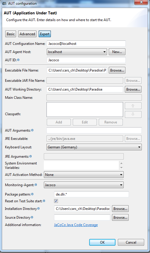

Re: RCP Jacoco [message #1611205 is a reply to message #1610522] Wed, 11 February 2015 03:07 Go to previous messageGo to next message
Hey,
no my Path are all absolute.
I've tried to run the Mail Template (Example of Eclipse for RCP Applications). Same Problem with Code Coverage.
Btw. by trying to Object Map using Eclipse as an AUT Eclipse crashes.
My AUT Conf : PARADISE is the Application Name.
index.php/fa/20798/0/
Also tried with Empty package pattern and my Workspace as Source Directory
Chris

Re: RCP Jacoco [message #1611271 is a reply to message #1611205] Wed, 11 February 2015 03:59 Go to previous messageGo to next message
Thanks for the config dialog. Can you add the following information for me:
- The exact paths you are using in the installation directory and for the executable file name (I can't see the end of them)
- check in the AUT Agent log for any entry at the time when you try to start the AUT and add the information here
- just to be 100% sure - when you try to start the AUT without JaCoCo, (just deselect the JaCoCo from the AUT configuration dialog), it works fine, right?
- can you remind me what version of Jubula you are using?
Thanks!
Alex
Re: RCP Jacoco [message #1611480 is a reply to message #1611271] Wed, 11 February 2015 06:45 Go to previous messageGo to next message
Paths:
Installation directory: C:\Users\cars_ch\Desktop\Paradise
Executable file name: C:\Users\cars_ch\Desktop\Paradise\PARADISE.exe
AUT Agent Log:Quote:
2015-02-11 12:39:40.565 [Connection.ReaderThread:Socket[addr=localhost/127.0.0.1,port=60001,localport=53054]] ERROR o.e.j.c.i.c.StartAUTServerStateCommand - AUTServer could not start: invalid arguments
Without JaCoCo it's working fine, I've already run some Tests on that.
Jubula Version: 8.1.0
Chris
Re: RCP Jacoco [message #1613363 is a reply to message #1611480] Thu, 12 February 2015 10:57 Go to previous messageGo to next message
Hi Chris,
Thanks for the extra info. I'm unsure what the problem could be at the moment. One thing does confuse me about the AUT configuration dialog that could be a reason. Can you:
1. Use ctrl+x on the executable file field to remove the path
2. Remove the ../jre/bin/java.exe from the JRE executable field
3. Re-paste the executable file into the executable file field
4. Click all the OKs and then try again?
This shouldn't make a difference, but it's worth a try. If that doesn't help then I'll forward this on to see who else can provide input.
Alex

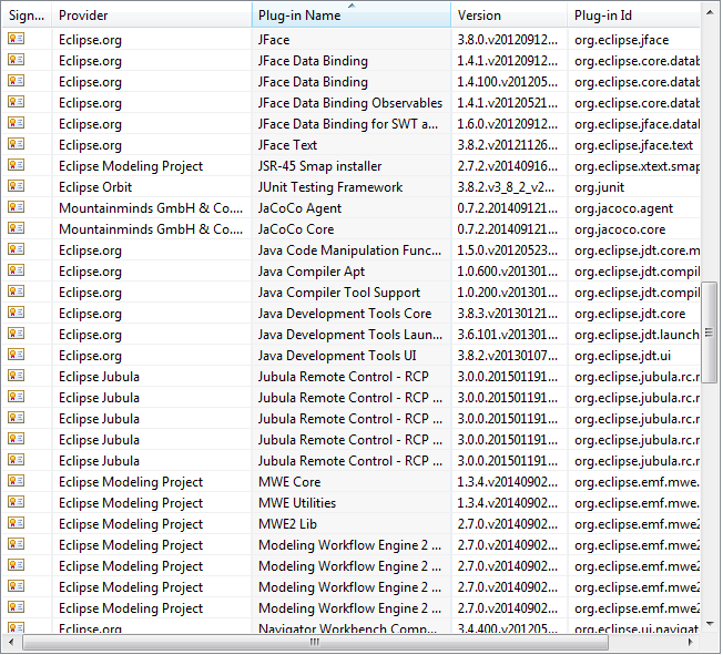

Re: RCP Jacoco [message #1619406 is a reply to message #1615011] Mon, 16 February 2015 10:01 Go to previous messageGo to next message
Hi Chris,
It would help us further if you could try to start your AUT with JaCoCo running (we use version 0.6.3), without Jubula. If your AUT starts when you've attached the JaCoCo agent, then we need to figure out where the difference it. If not, then at least that gives the avenue to look at.
Alex
Re: RCP Jacoco [message #1620483 is a reply to message #1619406] Tue, 17 February 2015 03:05 Go to previous message
AUT is running with the JaCoCo Agent see in Picture:
index.php/fa/20880/0/
Also you see the RCP Plug-Ins
