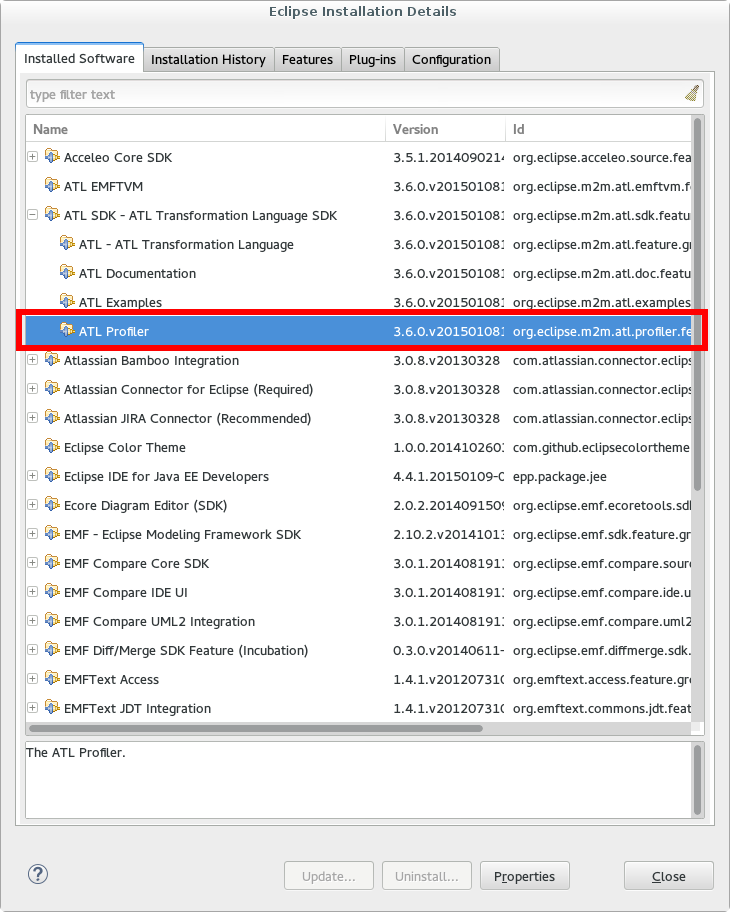

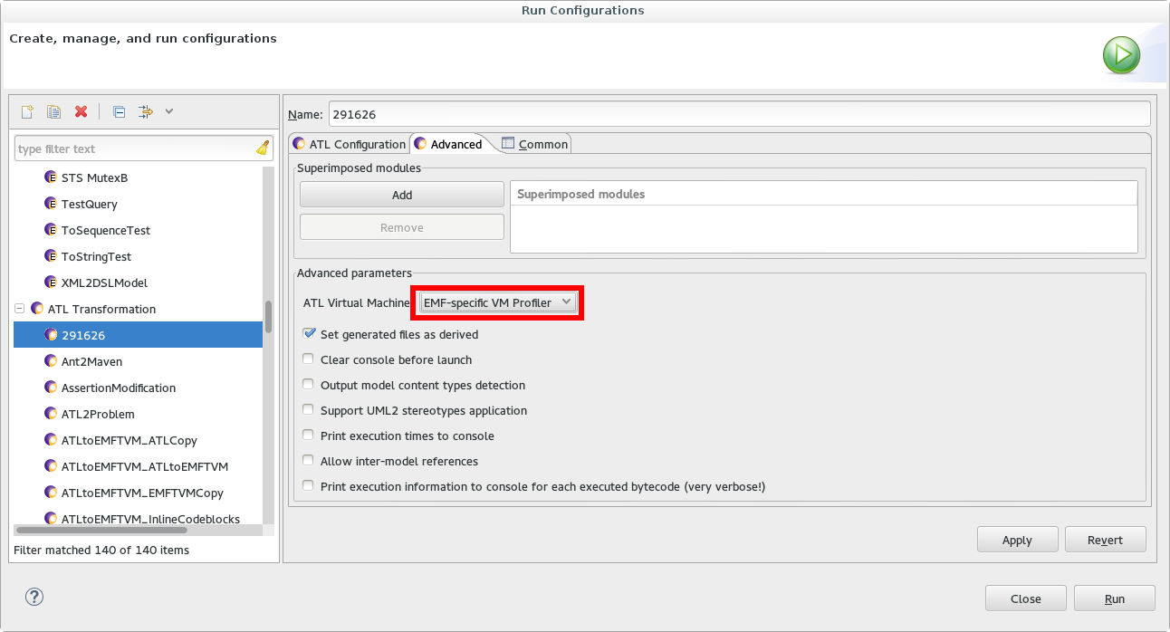

The ATL profiler can still be selected as an ATL VM, provided that you have the "ATL Profiler" feature installed. I've attached some screenshots:
index.php/fa/20773/0/
index.php/fa/20772/0/

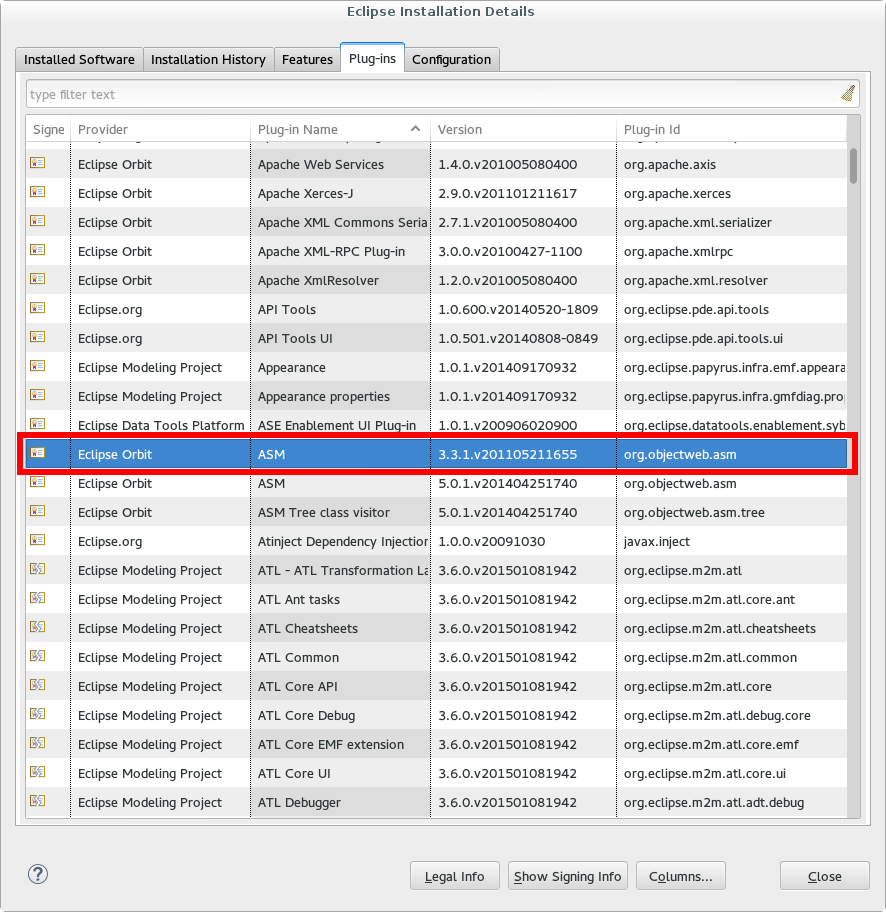

The ASM library is available as an OSGi bundle in Eclipse Orbit. It should already be in your Eclipse plugins folder when you installed ATL EMFTVM. See attached screenshot:

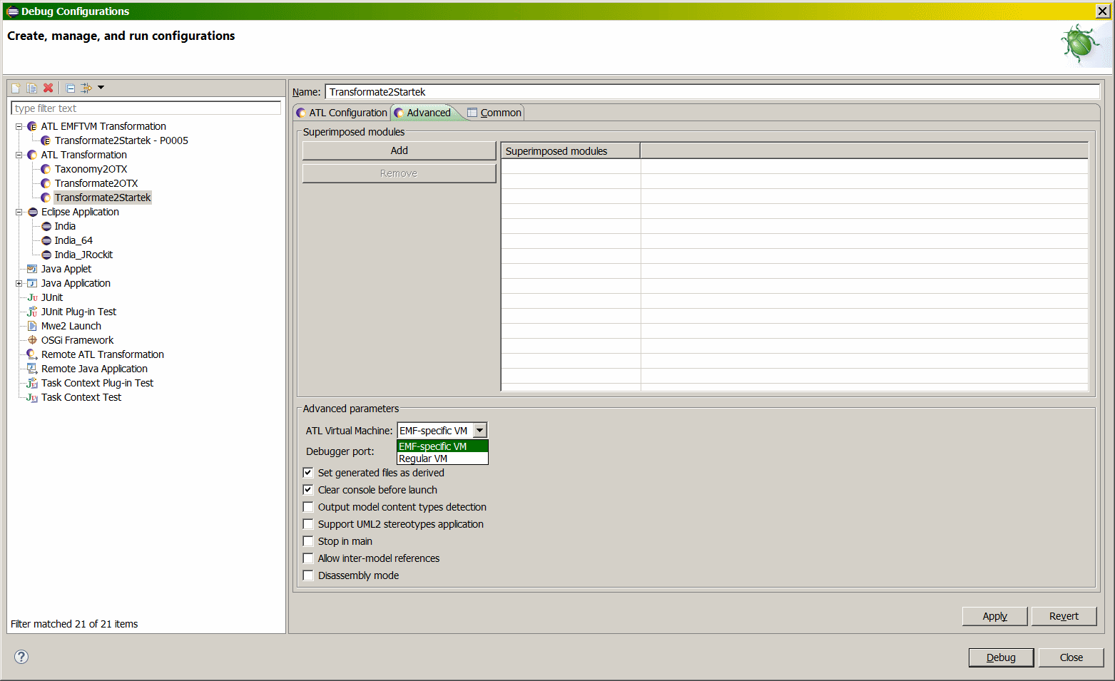

Dennis, thank you for your support. I'm going to look at EMFTVM once more as soon as possible.
There's still a problem with the ATL Profiler(s). The bundles are loaded:
WARNING: This console is connected to the current running instance of Eclipse!
osgi> ss atl.profiler
"Framework is launched."
id	State       Bundle
824	ACTIVE      org.eclipse.m2m.atl.profiler.core_3.6.0.v201412161312
825	ACTIVE      org.eclipse.m2m.atl.profiler.emfvm_3.6.0.v201412161312
826	ACTIVE      org.eclipse.m2m.atl.profiler.exportmodel_3.6.0.v201412161312
827	ACTIVE      org.eclipse.m2m.atl.profiler.exportmodel.editor_3.6.0.v201412161312
828	ACTIVE      org.eclipse.m2m.atl.profiler.model_3.6.0.v201412161312
829	ACTIVE      org.eclipse.m2m.atl.profiler.ui_3.6.0.v201412161312
830	ACTIVE      org.eclipse.m2m.atl.profiler.vm_3.6.0.v201412161312
but as you can see from the screenshot, I can't select any of them.
index.php/fa/20776/0/
Do you have any clue what is going wrong?
