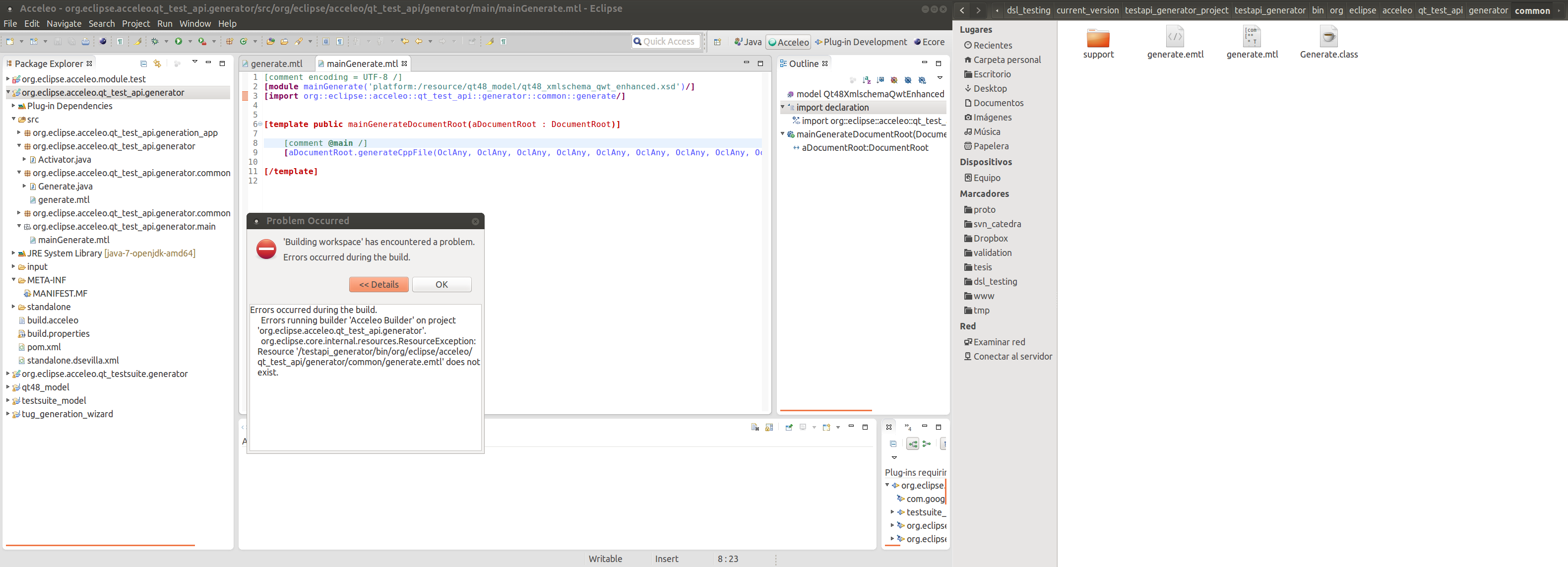

I am using Acceleo since a year ago. However, now I am facing a problem I can not solve. This problem is related to module imports, which are resolved during edition (no sintax errors are highlighted), but in compilation time I get this error:
Errors occurred during the build.
Errors running builder 'Acceleo Builder' on project 'org.eclipse.acceleo.qt_test_api.generator'.
org.eclipse.core.internal.resources.ResourceException: Resource '/testapi_generator/bin/org/eclipse/acceleo/qt_test_api/generator/common/generate.emtl' does not exist.
However, this compiled file called "generate.emtl" actually exists, as you can see in the attached figure. Some additional data that may be useful to understand the problem are:
