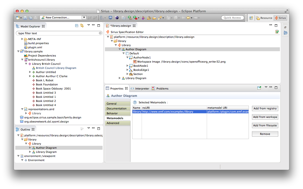

Re: Auto-completion not working for semantic candidates expression property [message #1619527 is a reply to message #1609986] Mon, 16 February 2015 11:49 Go to previous messageGo to next message
Hi Elvis,
It seems that the collection of EPackage used in
AcceleoMTLInterpreter.java:567 might contain a null entry.
In your odesign on which you have the issue, do you use the metamodels
property (advanced tab) on your representation descriptions ?
If this property is emtpy, Sirius will get the available EPackage from
the EcoreRegistry, but if it is used it will get the EPackages
referenced in your odesign file.
Could you check you workspace and look for invalid ecore files ? check
the metamodels properties in your VSM and give us some additional
feddback on the bugzilla ?

Re: Auto-completion not working for semantic candidates expression property [message #1643620 is a reply to message #1619527] Sun, 01 March 2015 12:29 Go to previous messageGo to next message
Hi Maxime,
I did as you asked, and the auto-completion feature works.
index.php/fa/21027/0/
