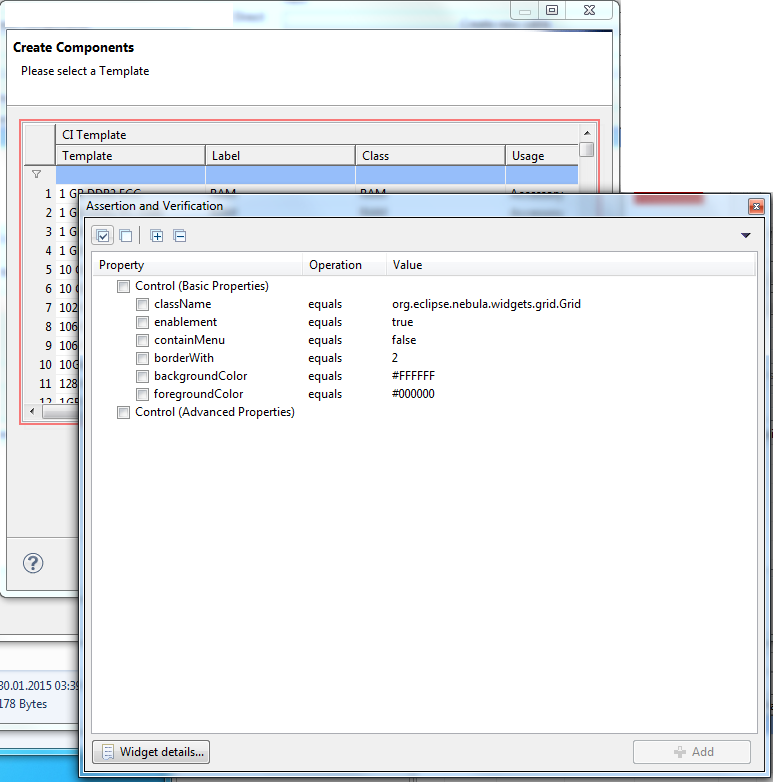

I'm trying to write an ECL script to interface with my AUTs nebula grids.
with [get-window "Create Components Wizard"] {
	get-nebula-grid | get-item "RAM" | get-item-cell -column "Label"
I've tried using get-nebula-grid, get-items, get-row-header based on the examples in the ECL Documentation but the execution always fails at with the message:
Scriptlet GetNebulaGrid not found
at get-nebula-grid
Attached is a screengrab of the grid in my AUT [nebula_widgets_grid_Grid.png], widget information [nebGrid_info.txt], and the failed test case's execution details [failed_testcase.txt].
If it's possible, I need to enter text into the grid's search fields (top row in blue in the screenshot).

Re: Error with get-nebula-grid [message #1690089 is a reply to message #1687003] Wed, 25 March 2015 04:18 Go to previous messageGo to next message
I am using the latest RCPTT 1.5.5 yet I see an issue with my Nebula Grid. I am unable to select an item in a particular row and column. Can some one help?
I don't have a label for get-item, and I am using the following which shows an error in get-item.
get-view XYZ| get-nebula-grid | get-item-cell "Deleted Info" -index 144 | get-item | get-text | equals "00200000" | verify-true
Figured this out:
During development, they have changed the plugin name org.eclipse.nebula.grid.widget to com.<something>.nebula . I think RCPTT finds everything using the exact plugin widget name. My college has the original name, but my product had a different plugin name.
Could this be issue. I think this is the case. Could some one conform if you have faced an issue.
It is not a custom widget, it is the same nebula grid with changed name.
Thank you
