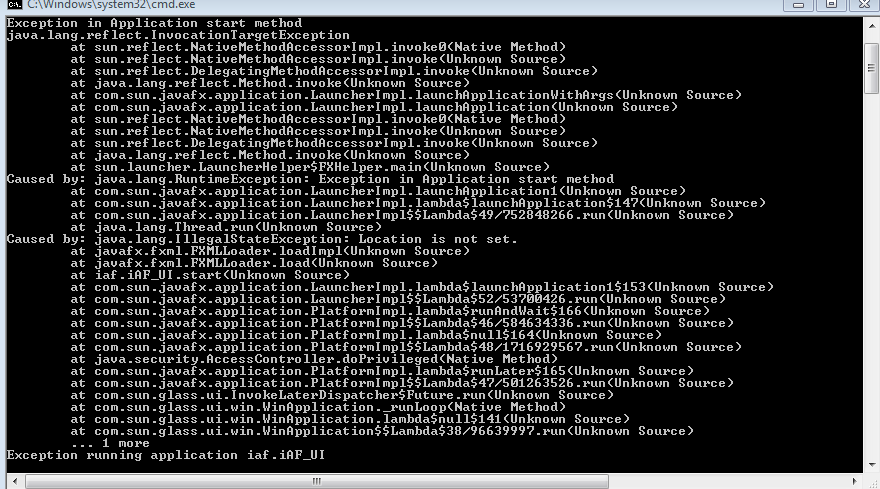

Re: Jar file not running on double click. [message #1597598 is a reply to message #1592034] Mon, 02 February 2015 07:14 Go to previous messageGo to next message
Yes I did,
PFA the screenshot with the error details.
Swati
  • Attachment: Capture.PNG
    (Size: 43.93KB, Downloaded 311 times)
Re: Jar file not running on double click. [message #1597619 is a reply to message #1597598] Mon, 02 February 2015 07:32 Go to previous messageGo to next message
so
a) You miss to package your fxml-Files with the app
b) You are using relative paths in your java code who don't work in a
jar filesystem
What does the code look like iAF_UI.start()?
Tom

Re: Jar file not running on double click. [message #1598854 is a reply to message #1598806] Tue, 03 February 2015 02:46 Go to previous message
Did you inspect the jar file and is the fxml file there? Do you by
chance have a typo with upper/lower case which works in eclipse because
the windows filesystem is caseinsenstive?
Tom
