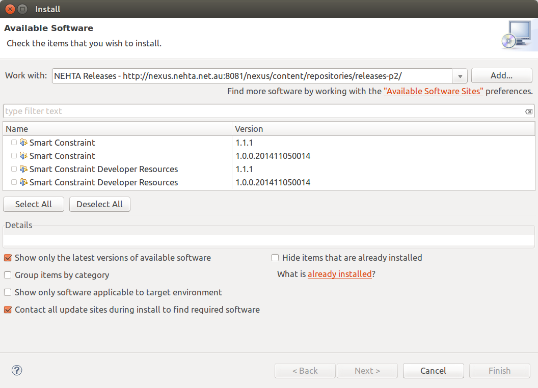

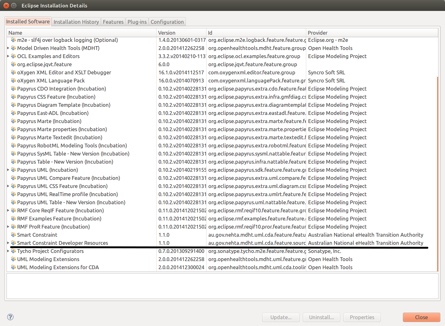

I'm having an issue where Eclipse's 'check for updates' feature is not registering any new updates, yet looking at the repository confirms the new version (different from the installed version) and installing the new software works fine.
What could be the issue?
There's nothing out of the ordinary in the .log file either as related to p2.

It looks to me that you have the latest SmartConstraint installed. 1.1.1 > 1.0.0? Or am I missing something?
Re: P2 seeing new software, yet not counting it as an upgrade [message #1589951 is a reply to message #1586635] Wed, 28 January 2015 14:05 Go to previous messageGo to next message
Installed is 1.1.0, and while 1.1.1 is available, Eclipse is not thinking it is an upgrade Confused
