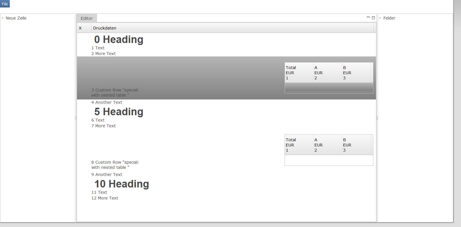

I am working on an E4 RAP/RCP application, where the main part is an editor with a list of (approx. 1000) rows consisting of an arbitrary composite. The composites in each row must allow editing of the containing elements, drag and drop, adding, removing (for an example see screenshot in the attachment).

Do you have any advice, or an hint how to solve this problem?
I am thinking about optimizing the GridLayout (show only composites in visible range with caching of the upcoming rows).
Another way would be the DataTable from the Google Visualization widget, where I can render my row content with html directly. But unfortunately, it is not available for e4 RAP, right?
Or is there another way you would suggest? If there are questions about my editor "table" or something is not clear, feel free to ask.
