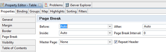

Check the Page Break Interval on the Table Properties tab. Set it to 0 unless you want to control the page break.
index.php/fa/20591/0/

Thanks for your reply Jerry,
but I think that I have some configurations about the page or something...
Now, if I modified your parameters, I export this pdf...
I am using a scripting to fill the fields table.
i need the same appearance that the second sheet of the first pdf document.
