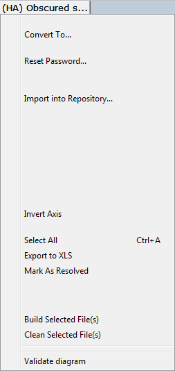

Same problem with tables already present. When right-clicking on the table tab (second time, first time menu is blank) in the editor I get this menu:
index.php/fa/20662/0/

Re: No table context menu after SR1a update? [message #1593139 is a reply to message #1592616] Fri, 30 January 2015 07:46 Go to previous messageGo to next message
Hi Tomas,
When the menu looks like this, this is caused by an exception during the creation of the menu. There is probably an error log entry associated to it. Can you please send the detail of the exception?
