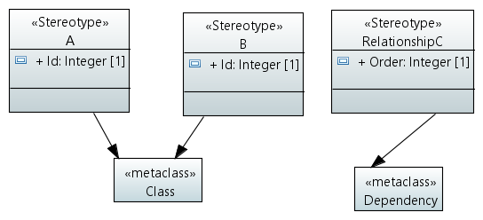

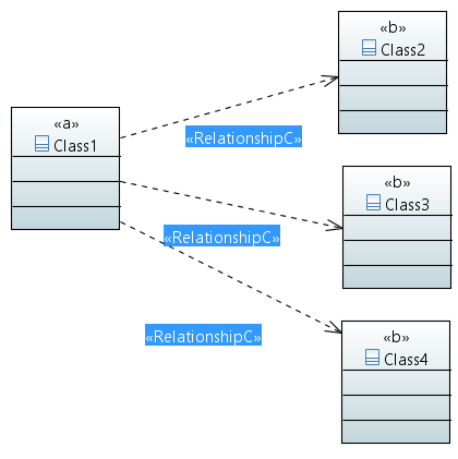

I have defined two stereotypes (A and B), and a stereotype for a
dependency (RelationshipC) in a profile to relate A and B stereotypes.
RelationshipC has an attribute 'Order' that is supposed to be used to
specify an ordering between the several instances of RelationshipC that
an A element could have with several Bs (please, see the images attached).
I've written some OCL that gets the relationships from a specific A
element and it works.

However, I would like to get the dependencies sorted according to its
'Order' attribute. I guess I should use something like:
self.clientDependency->select(p : UML::Dependency |
p.getAppliedStereotypes().qualifiedName->includes('profile::RelationshipC'))->sortedBy(Order)
But I can't find examples on how to use sortedBy.
Could anybody help me?

> On 20/01/2015 12:18, "V. López" wrote:
>> Thanks for the quick answer Ed, it worked in the console.
>> However, I would like to use it also in Acceleo.
>> Thus, "extension_RelationC" nor oclAsType(profile::RelationshipC) syntax
>> work with my own profile, at least without registering the profile by
>> creating a plug-in.
>> Is there a workaround to use sortBy in that situation or an alternative
>> way of ordering?
>> Greeting,
>> Víctor
>> El 19/01/2015 a las 19:02, Ed Willink escribió:
>>> Hi
>>> What you are doing is nearly right, but because you are using the UML2
>>> project Java API you have lost type information, which you could
>>> re-instate with an oclAsType(profile::RelationshipC).
>>> The new Povot-based Xtext support in the OCL project is moving to
>>> supporting stereotype navigation in a type-safe fashion as hinted at by
>>> the UML specification.
>>> Something like (untested) might be better
>>> self.clientDependency->selectByKind(UML::Dependency).extension_RelationshipC->sortedBy(Order)
>>> Traditionally sortedBy takes an expression that computes a
>>> String/Integer that determines the sort order. The Pivot-based support
>>> introduces an OclComparable type for use as the sortedBy argument type
>>> so that it is extensible to arbitrary user types such as Date.
>>> Regards
>>> Ed Willink

>>>> Hi all,
>>>> attached).
>>>> Please, find attached also the project with the profile and the model
>>>> that uses it.
>>>> Greetings,
>>>> Víctor
