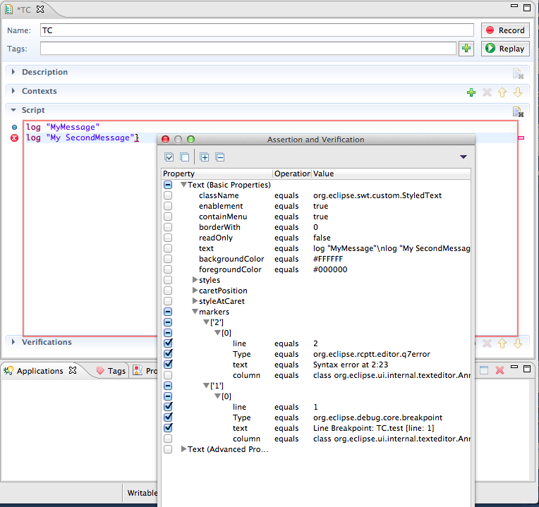

In my AUT if there is any error in the Text editor then in the left ruler a error sign is showed on that specific line and if one hover the mouse over that sign it shows the actual error massage. Testcase need to verify whether the error massage appears or not. But whenever I remove the mouse from the error sign on the left ruler the actual error massage disappears . So I am unable to assert anything . Is there any way to verify this type of massage in RCP.

To verify ruler markers you need to select an editor text area in assertion mode and check markers property.
See the attached screenshot for the details.
index.php/fa/20485/0/
