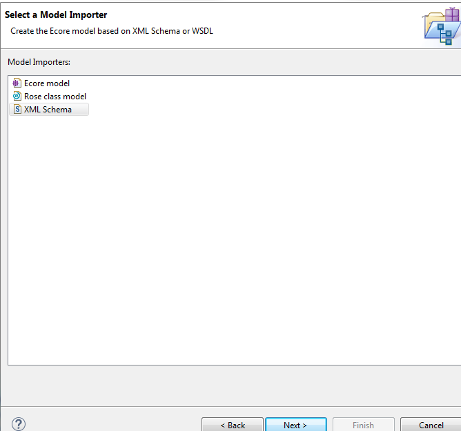

I would like to try the possibility to generate an ecore model from annotated java, but when I create a new EMF Project, the EMF Wizard (see screenshot) proposes only three importers : Ecore, Rose, and XML (I downloaded the XSD feature).
When looking in the OSGI-console from the running IDE, the java importer is there however, in the same way as the other three :
426 ACTIVE org.eclipse.emf.importer_2.9.0.v20141013-0308
427 STARTING org.eclipse.emf.importer.ecore_2.8.0.v20141013-0308
428 STARTING org.eclipse.emf.importer.java_2.7.0.v20141013-0308
429 STARTING org.eclipse.emf.importer.rose_2.7.0.v20141013-0308
1086 STARTING org.eclipse.xsd.ecore.importer_2.7.0.v20141013-0308
Any idea why this importer is missing in the wizard ?

Thomas,
All the other importers let you load a model source from outside of the
Eclipse workspace, but importing from Java has to be done from files in
the workspace. So if you have a Java project with the Java source you
can create a new Generator model and specify that it use annotated
Java. You could also create an empty EMF project and create your Java
files in there and then create a Generator model.

Ah thanks for the clarification. It's there indeed.
