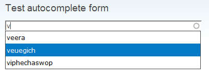

Hello Everyone,
I would like to know if any one has experience/ or resolved an issue with HTML toolkit testing an autocomplete form for example
index.php/fa/20443/0/
How do i select the text. In my case I used the HTML toolkit component type -List Action type - select entry by value is not working. In documentation it's not supported in HTML toolkit.
Using the concrete toolkit as well doesn't help matters.
How can i resolve this or is it a limitation?..
Thank you all for your anticipated response.
David.
Re: HTML toolkit - AUT [message #1567197 is a reply to message #1565527] Fri, 16 January 2015 02:57 Go to previous messageGo to next message
Hi there,
Thanks for the image and the information. What can the component be mapped as? To a desktop user, it looks like a combo box, but anything is possible in HTML Wink
