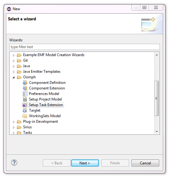

Is this possible and exists any tutorial how plugins can register additional setup tasks and project setup models?
For example setting PHP Version on project.

Hi Dawid,<br>
<br>
We offer a New Wizard for creating "Setup Task Extensions" from a
template:<br>
<br>
<img src="https://www.eclipse.org/forums/index.php?t=getfile&amp;id=20433" alt=""><br>
<br>
IIRC., the wizard is available if you provision a workspace with/for
the Oomph project itself. If you wait for another 15 minutes the new
"Oomph Setup UI IDE" feature should become visible in
<a class="moz-txt-link-freetext" href="http://download.eclipse.org/oomph/updates/latest">http://download.eclipse.org/oomph/updates/latest</a> (see bug 457432).
You'll need the EMF SDK installed, too.<br>
<br>
The wizard creates three skeleton plugin projects for you. If your
new task is called "DoThis" you'll find a "DoThisTaskImpl.java" file
in the created model plugin. You'll need to implement at least the
isNeeded() and perform() methods.<br>
