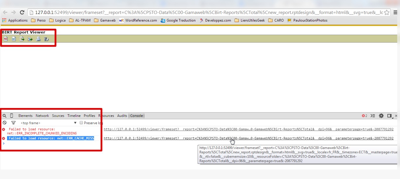

My issue is quite simple: i cannot preview any report from the designer, the "parameter screen" is not displayed.
When i am trying to preview into a web browser (Chrome or IE) i have a javascript error:
Failed to load resource: net::ERR_INCOMPLETE_CHUNKED_ENCODING
Failed to load resource: net::ERR_CACHE_MISS

Hi All, I just found a workaround: instead of using the usual button "View report" i am selecting "View report as html" and the parameters screen is displayed and the report is generating well.
It seems it is related with the toolbar.
I am still interested by any help on this, thanks in advance.
Re: Impossible to preview any report from Birt Designer [message #1560819 is a reply to message #1557821] Mon, 12 January 2015 15:51 Go to previous message
See if this applies, it worked for me
https://bugs.eclipse.org/bugs/show_bug.cgi?id=425786
