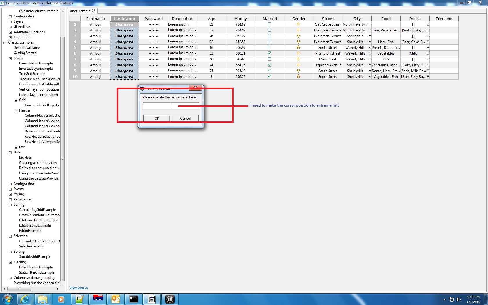

Hi Dirk
Thanks for the prompt reply.
.DIALOG_SHELL_LOCATION will specify the location of the Multi Edit Dialog
What I need is the location of the cursor inside the dialog, so that when ever the user enters the value it must begin from left not from the center
I guess you were talking about the below code

editDialogSettings.put(CellEditDialog.DIALOG_SHELL_LOCATION, location
Can you please suggest.
ATTACHING THE SCREEN SHOT
Ambuj

Re: Multi Edit Caret Location [message #1551068 is a reply to message #1551048] Wed, 07 January 2015 06:45 Go to previous messageGo to next message
That is part of your style configuration. I assume you are also showing the cell value centered and not left aligned. Try to register a different HorizontalAlignmentEnum for DisplayMode.EDIT
Re: Multi Edit Caret Location [message #1551089 is a reply to message #1551068] Wed, 07 January 2015 06:55 Go to previous message
Thank you Dirk
It is working as per my need.
Thanks for your prompt help.
