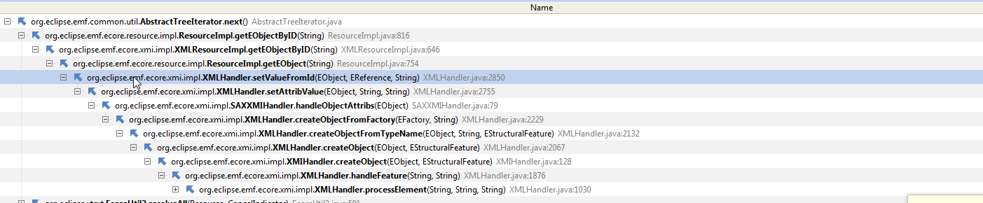

we are seeing some performance problems with Xtend2/Xtext projects that reference other projects/bundles that include .ecore's and we would like to discuss if the following analysis is correct.
In an RCP/Eclipse application that we implement, we have a lot of Xtext/Xtend2 projects and the Xtext builder tries to validate .ecore in referenced projects (for us, amongst others, this is Artop's gautosar.ecore). We see a lot of time spent here and an analyis with Yourkit gives the trace in the attached screenshot.
It seems that a lot of time is spent in org.eclipse.emf.ecore.resource.impl.ResourceImpl.getEObjectByID(String)
If we have a look at .ecore files, they don't seem to use XML IDs, do they? So that would mean that each reference lookup would cause a full model traversal in getEObjectByID?
Is it correct that XMLResource.OPTION_DEFER_IDREF_RESOLUTION would avoid that by trying to defer the reference resolution?
Yes, the default implementation of this is very slow. But note from the
call stack that it calls this first:
public EObject getEObject(String uriFragment)
int length = uriFragment.length();
if (length > 0)
if (uriFragment.charAt(0) == '/')
return getEObject(SegmentSequence.create("/",
uriFragment).subSegmentsList(1));
so you really must have an ID not a fragment path; a fragment path
starts with a '/'. When the ID is processed it does
protected EObject getEObjectByID(String id)
Map<String, EObject> map = getIntrinsicIDToEObjectMap();
if (map != null)
EObject eObject = map.get(id);
if (eObject != null)
return eObject;
So if you've called
org.eclipse.emf.ecore.resource.impl.ResourceImpl.setIntrinsicIDToEObjectMap(Map<String,
EObject>) with a map, it would look the ID up in that map, and if it
doesn't find it in the map, it will build a map so the next look-up is
fast. In combination with
org.eclipse.emf.ecore.xmi.XMLResource.OPTION_DEFER_IDREF_RESOLUTION that
should result in the resource's contents being traversed only once at
the end of XML loading rather than once per ID look-up. That should
perform well.
> If we have a look at .ecore files, they don't seem to use XML IDs, do they? So that would mean that each reference lookup what cause a full model traversal in getEObjectByID?
As you've noted, *.ecore files don't use intrinsic IDs, nor does the
Ecore model itself define any, so this performance problem must come
from some other type of resource...
Yes, in combination with using setIntrinsicIDToEObjectMap (normally
something you'd do in the resource factory).
> So would it make sense if
> org.eclipse.emf.ecore.xmi.impl.EcoreResourceFactoryImpl.createResource(URI)
> would set that option and could that improve our performance case?
I'd suggest setting a breakpoint in
to determine which type of resource is involved, and once you determine
that (I doubt its *.ecore), determine which resource factory creates it
and using setIntrinsicIDToEObjectMap in that factory.

Hi Ed,
thanks for the reply. I saw the code fragment dealing with "/" in the code, but forgot to mention it.
I think the culprit may be autosar.ecore. Artop generates all of the .ecore actually with ids:
<eStructuralFeatures xsi:type="ecore:EReference" name="hwType" eType="#_mmtG_1284267183">
... and
<eClassifiers xsi:type="ecore:EClass" xmi:id="_mmtG_1284267183" name="HwType"
eSuperTypes="#_mmtG__111740144 #_mmtG_1834162185">
Would that be dealt efficiently when the resource is created by the standard .ecore Resource Factory?
Andreas
No. Perhaps better that Artop not generate such an *.ecore.
