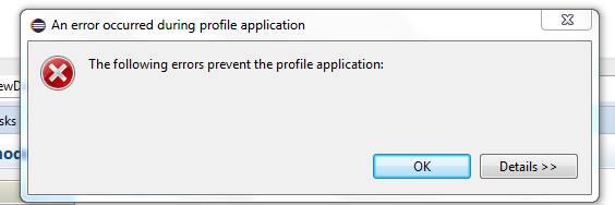

Re: MARTE profile example [message #1735865 is a reply to message #1541947] Thu, 23 June 2016 07:09 Go to previous message
I can't apply Marte profile too.
I followed these steps:
1) New>papyrus project
I give the name of the project, next I choose Profile.
2) New > papyrus model
I enter MARTE sources manually, using this link:
http://git.eclipse.org/c/papyrus/org.eclipse.papyrus.git/tree/extraplugins/marte/org.eclipse.papyrus.marte.static.profile/resources?id=8c0a29c3e4b19676126faf9e13e7029bf02d1a06&h=master
For step 1) , I used MARTE.profile.di, MARTE.profile.notation, MARTE.profile.uml.
For ste 2) I used MARTE_Library.library.di, MARTE_Library.library.notation, MARTE_Library.library.uml.
For the test of this profile,
New> papurys project.
When I apply the profile from properties, I had the attached error .
I'm using eclipse Luna , java se development kit 8 update 92
Please can you help me? Thanks in advance
