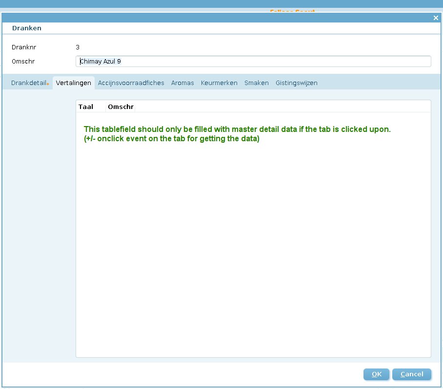

what is the best way to load the master detail data of the "TABS" ?
see below screenshot
index.php/fa/20319/0/
Only the data of the first tab should be retrieved when opening the form.
All other tabs should only have the data imported when they are consulted.
The data on the other tabs are almost always detail tables to the master.

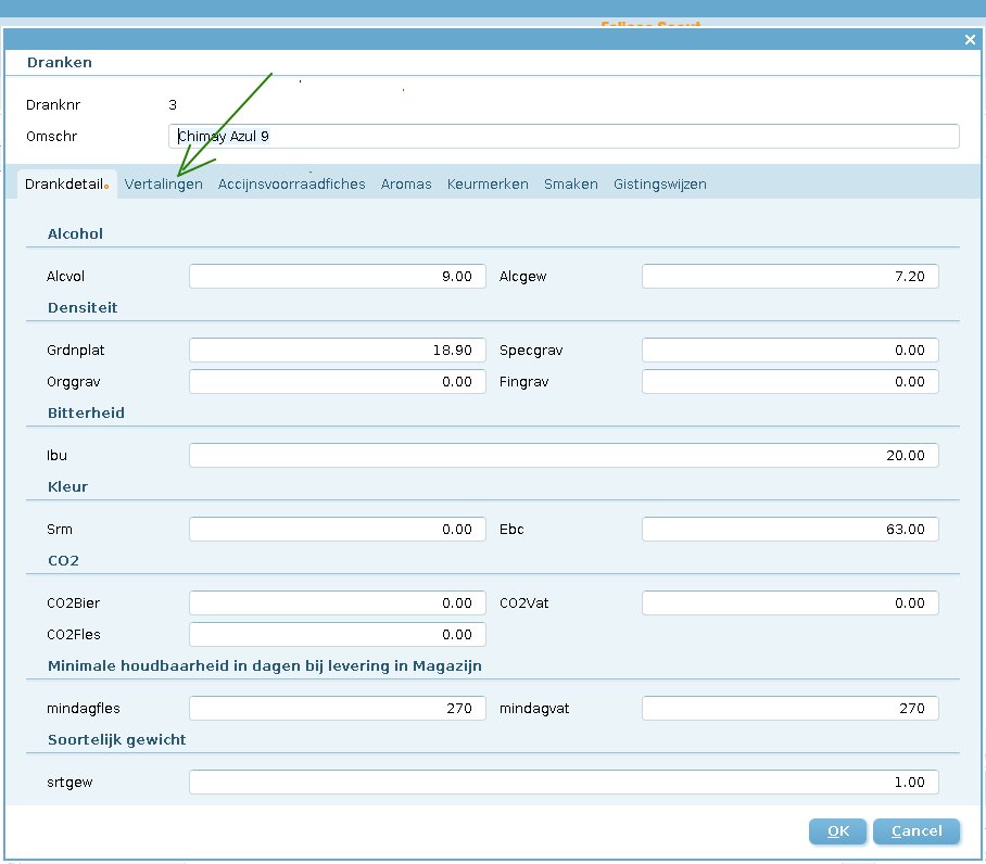

Below an example of the second tab sheet.
It is only necessary to import that data when on is looking at the tab sheet
index.php/fa/20320/0/
Is this possible ?

Re: Loading master detail data on tabboxes [message #1535514 is a reply to message #1534068] Mon, 29 December 2014 14:19 Go to previous messageGo to next message
Hello there,
I have not tried it yet. But I'll also need some kind of lazy loading in my app. My approach would be the org.eclipse.scout.rt.client.ui.form.fields.tabbox.AbstractTabBox.execTabSelected(IGroupBox) callback. There I would call a service to fill the TableFieldData according to the selected IGroupBox. The only open question for me is, how i can specifically invoke the importFormData method just for this particular table field, in order to get it displayed on the screen as well?
Regards, Peter
