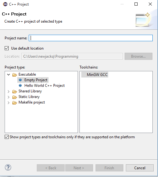

I am having a similar issue. I have both gcc and g++ through MinGW, but Eclipse only sets GCC as the toolchain regardless of wheteher the project is a C or C++ project. Of course as a C++ project requires G++ the build fails. If you found a solution please post.
  • Attachment: 584566.PNG
    (Size: 22.04KB, Downloaded 187 times)

index.php/fa/23582/0/I am having the opposite problem. I have gcc and g++. I create a c++ project and eclipse assigns gcc as the toolchain. Thus, build fails because there are no c++ libraries. If you have found a solution please post.
    (Size: 22.04KB, Downloaded 1352 times)
You should have a C++ compiler if your project nature is for C++. Try again with a C project.
