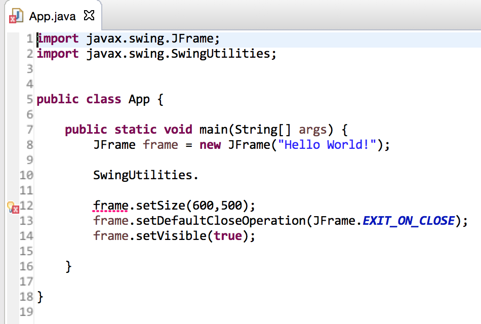

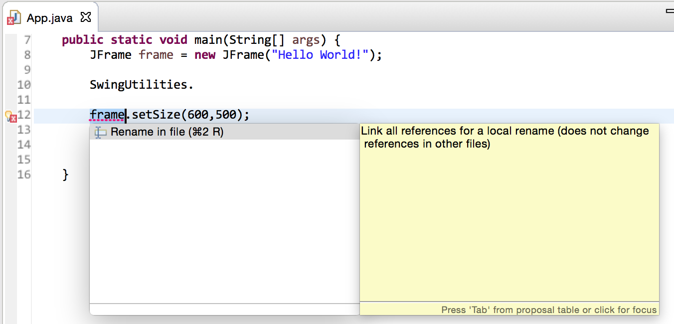

I was trying to follow a Swing tutorial from PluralSight (mastering java swing by John Purcell) and came across this weird behavior of Eclipse on my MacBookPro that hides several lines of codes automatically when I click on the error icon to the left of the code. I am attaching two snapshots, before and after, where initial few lines of code are not visible after clicking the error icon and applying a fix. There is no + or - icons to expand or collapse the code. The only way to restore the hidden lines is to close the project and re-open it.
Please note that I have verified that this is happening only with the Mac version of Eclipse Luna. The PC version does not behave in that way and clicking on the error icon simply applies the correct solution w/o hiding anything.
I am attaching the code here as well and I left the SwingUtilities statement hanging (unfinished) so that, I am hoping, someone could try to reproduce it and tell me what is the reason for this behavior. Note that I finished the code to its final working version and was able to run the code, but what bothers me is that some lines of code are hidden and I can't see them and that drives me crazy. I am assuming this is a bug with Mac version.

Before:
index.php/fa/20240/0/
After:
index.php/fa/20241/0/

My guess is that you have some how toggled the Only show the selected
Java element option on the Java->Editor preference page. This limits
the display to the selected java element.
You can turn it off by opening Window->Preferences and go to
Java-Editor. It should be right above the Appearance color options:
