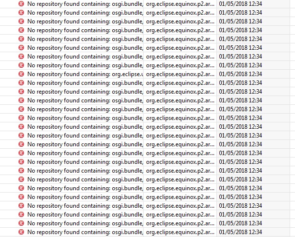

I m new with papyrus eclipse and I want to update the papyrus.
First i installed the latest version of eclipse-modeling-neon-3-win32-x86_64.
Then, I want to update the papyrus by:
-help
-install new software
- enter the site :"http://download.eclipse.org/modeling/mdt/papyrus/updates/releases/neon"
and I select all.
The installation does not complete and a big set of errors has been appearing:
No repository found containing: osgi.bundle,org.eclipse.rmf.reqif10.xhtml,0.13.0.201509161042
The list of errors is shown by the attached file.
Can someone helps me please.
  • Attachment: error.jpg
    (Size: 221.81KB, Downloaded 129 times)
