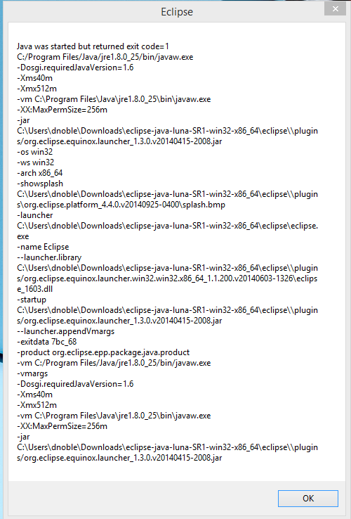

Could not start Eclipse, added the -vm location and was able to start it once. Will not launch anymore. Any Ideas ?

It looks like the -vm param is specified at least 3 times. Can you show us your eclipse.ini contents? Also, what version (64 vs 32-bit) of Java 8?

Eric.. That was the problem. Went back and check my .ini the location was already specified.
Thank you for your help. Easy Fix..
