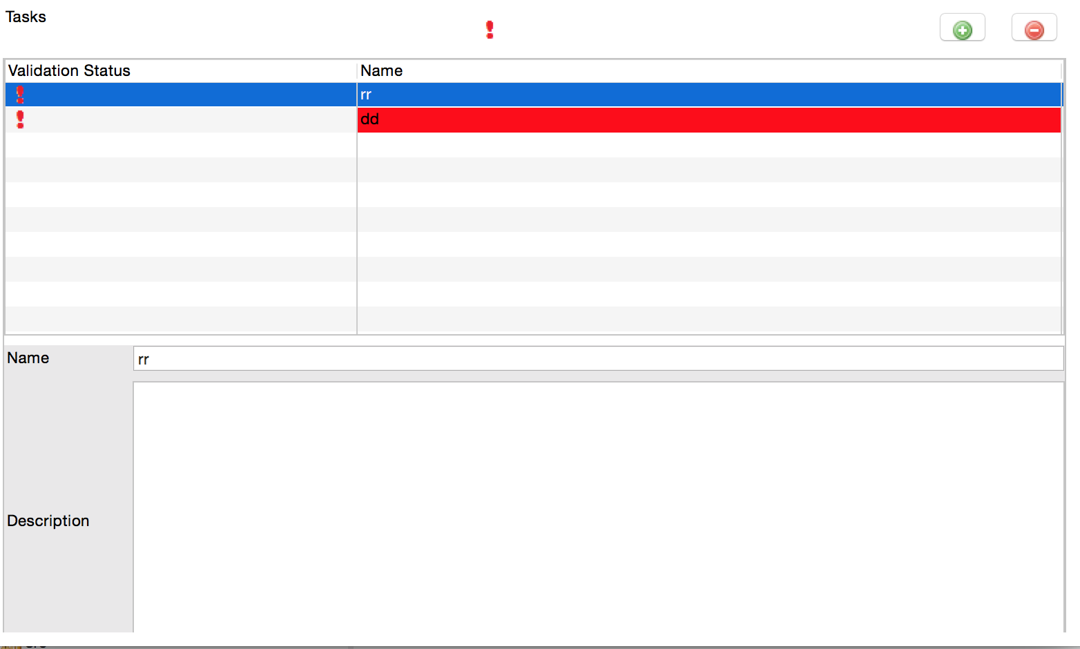

i execute the e4 sample application. I change the viewmodel to a master/detail panel to edit a task.
But i get always a validation error: Task needs to have a name. All task have a name (see screenshot).
Anybody an idea what's wrong?

yes this is probably due to:
https://bugs.eclipse.org/bugs/show_bug.cgi?id=437595
Best regards
Jonas
