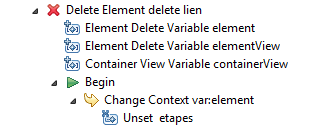

I have a Node object with a [0..*] relationship to other Node Object.
Creating edges works fine. I have a problem in the delete action of this edge using an "Unset".
I tried to do that :
Begin
|_ Change Context var:element
|_ Unset (Feature Name = "etapes"; Element Expression = "[elementView.oclAsType(DEdge).targetNode.oclAsType(DNode).target/]")
index.php/fa/20207/0/
But it doesn't work and i don't know how to solve it.
Anyone can help me or tell me other solution to delete my relationship?
Thanks for the attention.
  • Attachment: unset.PNG
    (Size: 6.37KB, Downloaded 630 times)

THe change context should reference the edge source semantic element by
using the same expression you defined within the unset
"[self.sourceNode.oclAsType(DNode).target/]"
The unset "element expression" have to return a collection of elements
to unset from the feature (the edge semantic target in your case)
try with Element Expression =
"[elementView.targetNode.oclAsType(DSemanticDecorator).target/]"

Hi Florian, thanks for your answer.
I followed your instructions but i still have the problem with the following error message :
!MESSAGE Compilation error for expression [elementView.oclAsType(DEdge).targetNode.oclAsType(DSemanticDecorator).target/] : Unrecognized variable: (DSemanticDecorator)
Begin
|_ Change Context [elementView.oclAsType(DEdge).sourceNode.oclAsType(DNode).target/]
|_ Unset (Feature Name = "etapes"; Element Expression = "[elementView.oclAsType(DEdge).targetNode.oclAsType(DSemanticDecorator).target/]")
Thank you for your help.

Replace DSemanticDecorator by viewpoint::DSemanticDecorator; (the
acceleo parser needs of the package in this case)

Thank you for the reply. But, i have the same error...
Re: How to delete edges !! [message #1515912 is a reply to message #1514807] Thu, 18 December 2014 08:45 Go to previous message
That's strange. And if you replace DSemanticDecorator by a more concrete
type ? (DNode, DNodeList, following what is the real element behind)
Florian - Obeo
Need professional services for Sirius?
