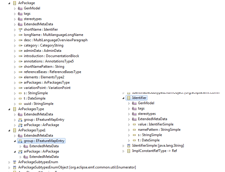

So, this was working pretty fine. A few days ago I wanted to do the same as before. Got me the an AR 4.0.3 XSD, set up the project as before. It worked at first, until something strange happened.
The "eGet( attrib )" does not work on sub-elements anymore.
This, for example, works on the top level elements without a problem

However, going deeper into the structure, it spits out an exception like
"The feature 'shortName' is not a valid feature" (example based on the Tag "shortName" which is mapped in eCore as attribute.
index.php/fa/20204/0/
Well, since I first try to figure out what's going wrong I sat here two days single stepping and trying different access methods and files.
I found out that in deeper nested elements following statement became true
EClass MyClassObj = eRefObjArPckgs.getEReferenceType();
MyClassObj.getEAllAttributes() != MyClassObj.eClass().getEAllAttributes()
So, even if I find an specific attribute (EStructualFeature), this is not found in the "sub-class" .eClass() !
eClassArPckg.getEAllAttributes(): [org.eclipse.emf.ecore.impl.EAttributeImpl@35059fcd (name: shortName) (ordered: true, unique: true, lowerBound: 1, upperBound: 1) (changeable: true, volatile: false, transient: false, defaultValueLiteral: null, unsettable: false, derived: false) (iD: false), org.eclipse.emf.ecore.impl.EAttributeImpl@13a6ac2e (name: category) (ordered: true, unique: true, lowerBound: 0, upperBound: 1) (changeable: true, volatile: false, transient: false, defaultValueLiteral: null, unsettable: false, derived: false) (iD: false), org.eclipse.emf.ecore.impl.EAttributeImpl@38e711a6 (name: s) (ordered: true, unique: true, lowerBound: 0, upperBound: 1) (changeable: true, volatile: false, transient: false, defaultValueLiteral: null, unsettable: false, derived: false) (iD: false), org.eclipse.emf.ecore.impl.EAttributeImpl@2dbf1522 (name: t) (ordered: true, unique: true, lowerBound: 0, upperBound: 1) (changeable: true, volatile: false, transient: false, defaultValueLiteral: null, unsettable: false, derived: false) (iD: false), org.eclipse.emf.ecore.impl.EAttributeImpl@6fd99ff4 (name: uuid) (ordered: true, unique: true, lowerBound: 0, upperBound: 1) (changeable: true, volatile: false, transient: false, defaultValueLiteral: null, unsettable: false, derived: false) (iD: false)]
eClassArPckg.eClass().getEAllAttributes(): [org.eclipse.emf.ecore.impl.EAttributeImpl@31ef45e3 (name: name) (ordered: true, unique: true, lowerBound: 0, upperBound: 1) (changeable: true, volatile: false, transient: false, defaultValueLiteral: null, unsettable: false, derived: false) (iD: false), org.eclipse.emf.ecore.impl.EAttributeImpl@6adede5 (name: instanceClassName) (ordered: true, unique: true, lowerBound: 0, upperBound: 1) (changeable: true, volatile: true, transient: false, defaultValueLiteral: null, unsettable: true, derived: false) (iD: false), org.eclipse.emf.ecore.impl.EAttributeImpl@2d928643 (name: instanceClass) (ordered: true, unique: true, lowerBound: 0, upperBound: 1) (changeable: false, volatile: true, transient: true, defaultValueLiteral: null, unsettable: false, derived: true) (iD: false), org.eclipse.emf.ecore.impl.EAttributeImpl@5025a98f (name: defaultValue) (ordered: true, unique: true, lowerBound: 0, upperBound: 1) (changeable: false, volatile: true, transient: true, defaultValueLiteral: null, unsettable: false, derived: true) (iD: false), org.eclipse.emf.ecore.impl.EAttributeImpl@49993335 (name: instanceTypeName) (ordered: true, unique: true, lowerBound: 0, upperBound: 1) (changeable: true, volatile: true, transient: false, defaultValueLiteral: null, unsettable: true, derived: false) (iD: false), org.eclipse.emf.ecore.impl.EAttributeImpl@20322d26 (name: abstract) (ordered: true, unique: true, lowerBound: 0, upperBound: 1) (changeable: true, volatile: false, transient: false, defaultValueLiteral: null, unsettable: false, derived: false) (iD: false), org.eclipse.emf.ecore.impl.EAttributeImpl@192b07fd (name: interface) (ordered: true, unique: true, lowerBound: 0, upperBound: 1) (changeable: true, volatile: false, transient: false, defaultValueLiteral: null, unsettable: false, derived: false) (iD: false)]

  • Attachment: ArMapping.png
    (Size: 33.62KB, Downloaded 485 times)

		/* we want to have an Arpackage*/
		for ( EStructuralFeature eObjFeat : eCoreObj.eClass().getEAllStructuralFeatures() )  {
			if ( EArxmlFeatures.ARPACKAGE.toString().equals(eObjFeat.getName())) {
				Object arPackageObj = eCoreObj.eGet(eObjFeat);
				if ( arPackageObj instanceof List<?> ) {
					@SuppressWarnings("unchecked")
					FeatureEList<EObject> arPackage = (FeatureEList<EObject>) arPackageObj;
					/* I don't want to hard code get(0) */
					for ( EObject eFeatListObj : arPackage ) {
						parseArPackage( eFeatListObj );
				} else {
					/* it must be an EObject, not a List<EObject> */
					parseArPackage( (EObject) arPackageObj );
			} else {

You can't make this general assumption that if it's a list is must be a
feature map. You can use
org.eclipse.emf.ecore.util.FeatureMapUtil.isFeatureMap(EStructuralFeature)
to test if a feature represents a feature map. But the whole code looks
a little suspect. It's not clear if this is only supposed to work for
arpackage instances or not. Otherwise it's all kind of arbitrary, i.e.,
if the object happens to have a feature with some specific name, you'll
going start making assumptions about it...
Well, that was my assumption... BUT it didn't work
When I do the following (test code)
for ( EStructuralFeature eObjFeat : eCoreObj.eClass().getEAllStructuralFeatures())  {
			if ( featureName.equals(eObjFeat.getName())) {
				retVal = eCoreObj.eGet( eObjFeat );
				System.out.println( FeatureMapUtil.isFeatureMap( eObjFeat));
			} else {
I always get a false, although it returns a feature list. However, if I try to apply this function on the object returned from eGet() and cast it forcefully to "EStructuralFeature" I will, obviously, catch a ClassCastException since I am not allowed to cast a "FeatureMap$FeatureEList" to that very type.
List works pretty well on that list type (I guess that's the problem here for the helper function to fail... {IMHO} ).

I think I can explain that in three sentences as well.
I am not getting a FeatureMap for that structural element, instead I am getting its inner class FeatureEList. That is why I check for a list instance. It might be the previously mentioned helper class which does this "deviation".
I saw from your link, your article, that you eventually/usually retrieve a FeatureMap for the kind of elements I am evaluating (which you try me to tell to take care of as well?!).

I see. Don't read to much information into the specific implementation
classes. It's a little like observing in the debugger that you're
working with a LinkedList verses an ArrayList, but in the end you only
need to be considered (typically) it it's a List. So check things like
feature.isMany and if that's true, you can definite cast to List.
> retrieve a FeatureMap for the kind of elements I am evaluating.
Feature maps arise in many occasions and you can use
FeatureMapUtil.isFeatureMap to test for this.
