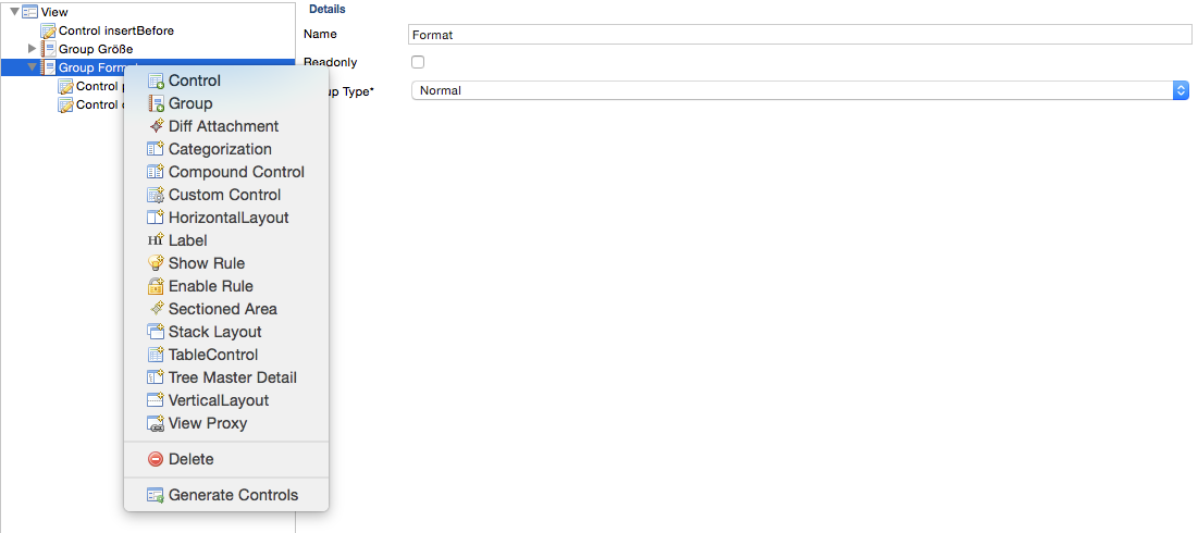

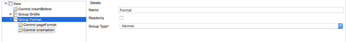

I add to a viewmodel (screenshot1) a view proxy model (screenshot2) the result are two vertical layouts (screenshot 3).

Re: ECP reuse a ViewModel [message #1504886 is a reply to message #1503406] Tue, 09 December 2014 11:59 Go to previous messageGo to next message
could it be, that this occurs only, if the preview is open? If so, this
seems to be a bug. View proxies are replaced during runtim and the
preview might do that. It should therefore work on a copy. Could you
retest this and report a BR?
Thanks!
Jonas

Re: ECP reuse a ViewModel [message #1504918 is a reply to message #1504886] Tue, 09 December 2014 12:30 Go to previous messageGo to next message
Yes first it's a view proxy model. If i press the refresh button it will replaced by the vertical layout.
What is the view proxy id? A Resource URI? The path to the other view model?
Re: ECP reuse a ViewModel [message #1505721 is a reply to message #1504918] Wed, 10 December 2014 03:56 Go to previous messageGo to next message
That is the id which is used to register the view model (in the
extension point).
