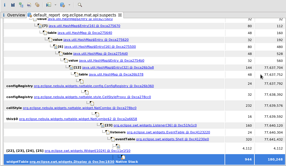

First, thanks for this project, and for the time you invest in maintaining it - it's great.
I'm using version 1.1.1.
I think there's a possible memory leak from the NatCombo class.
In Line 284 a listener is added to the shell:
		getShell().addListener(SWT.Move, new Listener() {
			public void handleEvent(Event event) {
				calculateBounds();
This listener is not removed when the nattable is disposed, and using the MAT plugins I found that it references up to the config registry with everything in it (see attached screenshot, it goes up to my model objects, which are memory consuming).
index.php/fa/20133/0/
Is this a bug? Or is there a reason I'm not aware of for this behavior?

Re: Possible Memory Leak in NatCombo [message #1497505 is a reply to message #1497432] Wed, 03 December 2014 16:39 Go to previous messageGo to next message
Please open a ticket
Re: Possible Memory Leak in NatCombo [message #1498462 is a reply to message #1497505] Thu, 04 December 2014 07:22 Go to previous message
Bug link: https://bugs.eclipse.org/bugs/show_bug.cgi?id=454111
