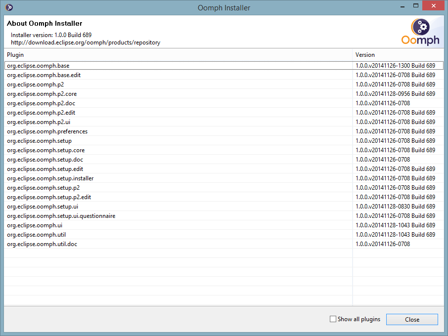

Before you try that, please make a screenshot of your old installer's About dialog and let me see it. Mine looked strange...

Re: NoSuchMethodError: OfflineMode.setEnabled() since update [message #1498227 is a reply to message #1498203] Thu, 04 December 2014 04:03 Go to previous messageGo to next message
Hi Eike,
thanks for the help!
The screenshot of the About window looks like this: https://www.dropbox.com/s/w56d1zdf0847fdm/Screenshot%202014-12-04%2009.59.12.png?dl=0
I'm also attaching the file for future reference.
index.php/fa/20137/0/
I will try with a fresh download of the installer and report on the results.
