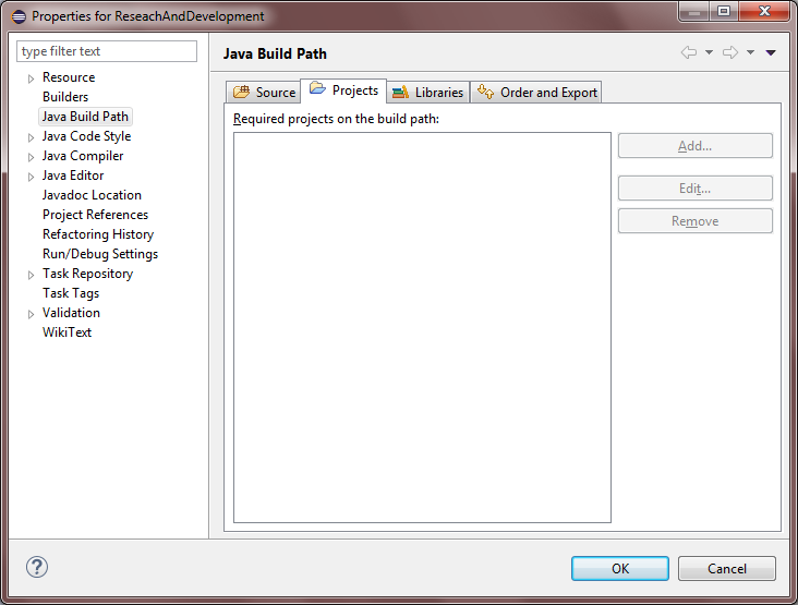

Ok, thanks. Regarding #2 above though, I think I discovered the problem I've encountered.
The "required" project (Common) must be open in order for me to add it. Or I get the following tab (with no way to add):
index.php/fa/20107/0/
And even after I add it, if I close the dependency project Common, then it can't be used in its build. This is counter-intuitive to me.
