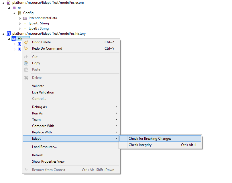

By only moving the attribute it is unclear to Edapt how it should
migrate the values in attribute B. Edapt can tell you that if you run
the Check Integrity Action (see Screenshot).
You need to use a refactoring operation to make this work:

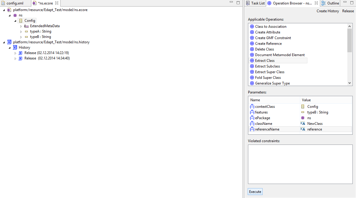

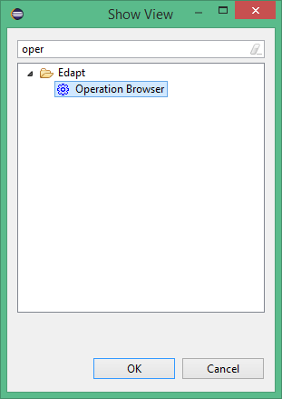

1. Open the operation browser view, see screenshot
2. Run the Extract Class Operation on the "Config" class to extract a
new class "NewClass" which is contained in a Reference "reference" in
"Config" and which will hold the "typeB" attribute, see Screenshot.

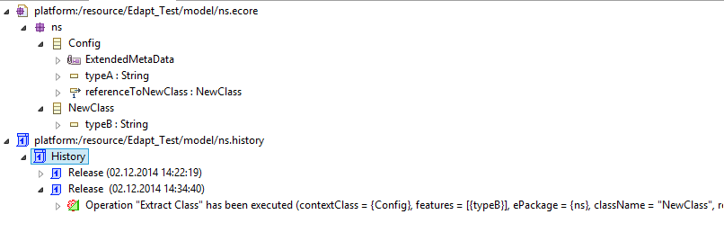

3. The history will then look similar to what you can see in the screenshot.
Now the history also passes the integrity check.
