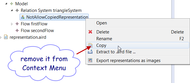

I would like to remove/hide Copy menu item from the context menu when right-clicking on a Representation as described in the image below
index.php/fa/20089/0/
As I know, the context menu is built via org.eclipse.sirius.ui.tools.internal.views.common.ContextMenuFiller
Does Sirius give us api to do the job?
Huy.
Re: How to remove/add a menu item from Context Menu of a Representation. [message #1495514 is a reply to message #1495266] Tue, 02 December 2014 04:15 Go to previous message
Le 02/12/2014 05:39, Huy Le a écrit :
> Hello,
Hi Huy,
Sirius does not currently provide api to remove those actions. But it
should be possible to add new menus with the org.eclipse.ui.menu or
org.eclipse.ui.popupmenus extensions point.
> Thanks,
> Huy.
Maxime - Obeo
