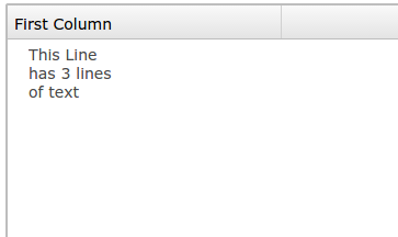

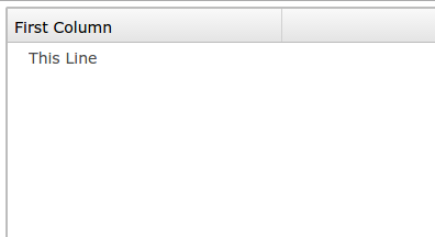

I have a problem with Nebula Grid.
The attached file is the smallest piece of code that illustrates the
issue I have.
The idea is to show a very simple Nebula Grid with Markup enabled.
The initial height is too small but is properly refreshed if the mouse
is moved just above the grid.
Do anyone have a suggestion on what I may have done wrong?
I attached the code and 2 screenshots
