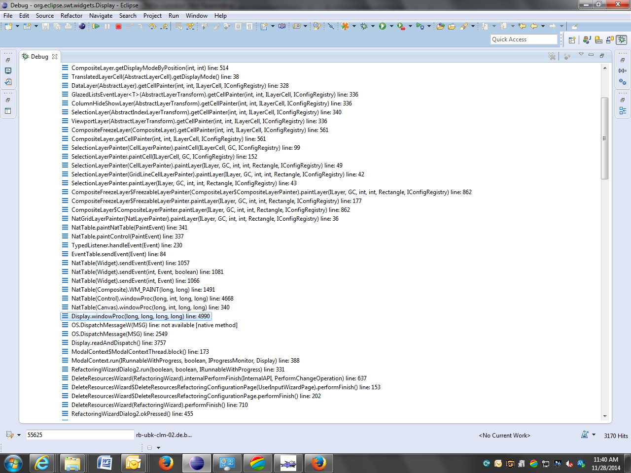

I have an RCP application open in one of my view I am using Nattable.
When i delete the project from the common navigator some how Nattable listen to the project deletion and keep getting redrawn or refreshed.
This in turn taking long time to delete the project from the workspace
I have attached the snapshot of the stacktrace, please have a look.
You we could see in the stracktrace, natable listen to some event triggered from delete project wizard.
can some one help me.
Thanks in advance.

I don't think this is an issue in NatTable. Maybe your view is listening to something that triggers a redrawal

As we could see in the stacktrace, IRowIdAccessor.getRowId() is triggered by deleteResourcesWizard.performFinish().
Nothing is triggered from my view.
Any Help?

I don't know about your NatTable composition, but maybe you are using GlazedLists? And maybe your list is listening to some collection that changes on performing finish on that wizard. And because you or anybody else listens to the changes of that list, NatTable refreshes.
