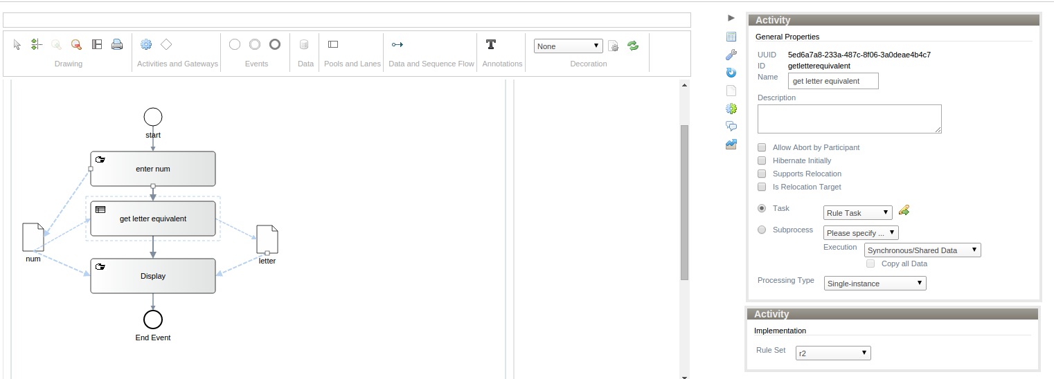

I created a rule set (r2) which has the following parameters:
  • n1 : Number (Input)
  • l1 : Text (Output)

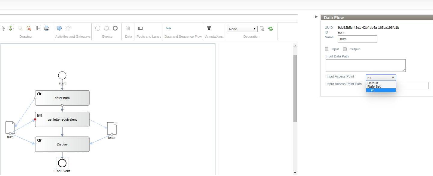

r2 is used by a rule task in Model15 and I have set the data mappings for both parameters
index.php/fa/19995/0/
index.php/fa/19996/0/

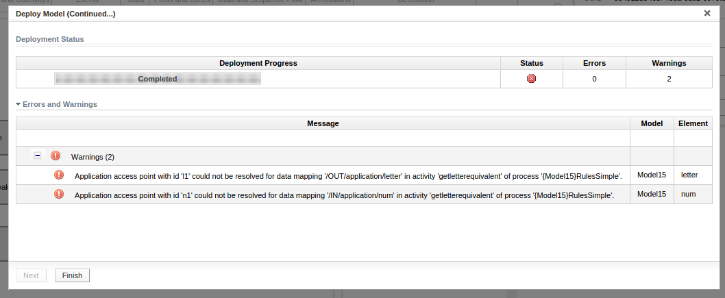

But when I deploy the model, I get the following warnings:
index.php/fa/19997/0/
Can someone help me figure out the problem?

Below is the error message when I deploy the model(please see stacktrace.txt for detailed version).
