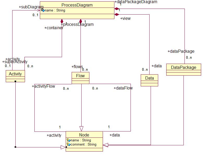

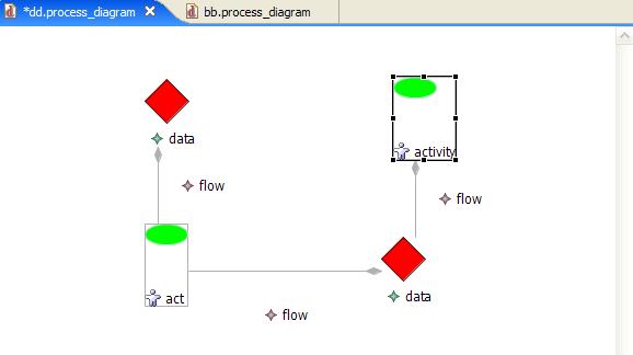

I have a flow which can link with data and activity, the picture shows my
model.
I want to do such constrains:
1, activity can not connect with activity
2,data can not connect with data
in other words, I don't want a node connect with another node with the same
class type.
what does the expression should I write in the "sourceEnd constraint" or
"targetEnd constraint" in link constraint in gmfmap?
can I get the class type of sourceEnd and targetEnd in ocl expression ?
self.getClass() <> oppositeEnd.getClass()

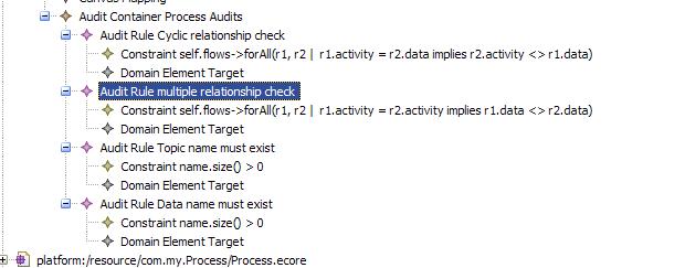

now I can create multiple connections between node A and node B, but I want
to limit user can only create one connection between nodes.
I know I can check this with audit function in gmfmap, but it was used to
show errors when I already create muliple connections between nodes, I want
to prevent user from creating multiple connections between nodes, how can I
implement this function?
best regards,
dzh
Re: OCL constrains [message #29489 is a reply to message #29115] Thu, 24 August 2006 20:01 Go to previous messageGo to next message
The best way to enforce a constraint like this is directly in your metamodel
by using multiplicity
and unique properties for a reference.
The connection creation should follow such restrictions.
I am not sure I fully understand your use-case at this point as you are not
much specific with respect to the metamodel.
However, If you are able to achieve this with audits, doing so by using link
constraints is just an analogy only
with the following difference:
link constraints are evaluated against nodes before a connection is
established
while audits are checked against the current state.
/Radek

Re: OCL constrains [message #30760 is a reply to message #29489] Fri, 25 August 2006 12:49 Go to previous messageGo to next message
Originally posted by: dzhpingbo.sohu.com
"Radek Dvorak" <radek.dvorak@borland.com> д
  • Attachment: model.JPG
    (Size: 45.26KB, Downloaded 126 times)
  • Attachment: audit Rules.JPG
    (Size: 26.84KB, Downloaded 102 times)
  • Attachment: tmp.JPG
    (Size: 13.09KB, Downloaded 111 times)

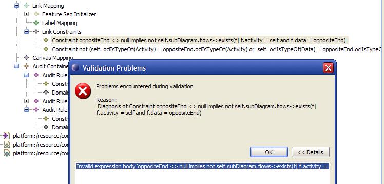

Re: OCL constrains [message #33659 is a reply to message #32152] Wed, 30 August 2006 02:56 Go to previous messageGo to next message
Thank you for your answers, which encourage me not to give up:)
yes, I update gmf with the maintenance build:
1.0 Stream Maintenance Build
M20060824 Thu, 24 Aug 2006 -- 16:00 (-0400)
but it still gives such error:
Diagnosis of Constraint oppositeEnd <> null implies not
self.subDiagram.flows->exists(f| f.activity = self and f.data = oppositeEnd)
Invalid expression body 'oppositeEnd <> null implies not
oppositeEnd)'. Cause: Invalid expression body 'oppositeEnd <> null implies
not self.subDiagram.flows->exists(f| f.activity = self and f.data =
oppositeEnd)'.
Cause: ERROR in (variableExpCS): (Unrecognized variable: (subDiagram))
I tried the expression works fine in audit: "self.flows->forAll(r1, r2 |
r1.activity = r2.data implies r2.activity <> r1.data)" ,but in sourceEnd
constraint, it report error with Unrecognized variable: flows.
could you please give me advices about how to solve it?

Re: OCL constrains [message #34555 is a reply to message #33659] Wed, 30 August 2006 11:13 Go to previous messageGo to next message
I assumed in the constraint I have posted that the source end context is
Activity node and
made a mistake taking the 'subDiagram' as a reference to its ProcessDiagram
container.
It was late, after 2:00AM so I saw the diamond which did not exist;-), sorry
for that.
Of course, the 'container' reference should be used instead of 'subDiagram'
which was unrecognized.
As for the contexts in general, It depends how you construct your link
mapping.
More precisely, what you specify as the LinkMapping::sourceMetaFeature which
becomes
the source end context.
Ananlogously, LinkMapping::linksMetaFeature forms the target end context.
The source or target roles are switched automatically in the editor if the
connection is
dragged in the opposite direction so you can stay focused on the link
mapping.
/Radek

Re: OCL constrains [message #34691 is a reply to message #33659] Wed, 30 August 2006 11:34 Go to previous messageGo to next message
To be complete, I can see in your UML model that Flow::activity link source
reference is of Node type,
so a cast to Activity is needed here to access the 'container' reference.
self.oclAsType(Activity).container.flows->exists(f| f.activity = self and
If there is still a mismatch in what is the source or target context here
(as I don't know your complete mapping),
I think you should be able to correct it yourself now.
Let me know if you have made it work ;-)
/Radek
> oppositeEnd)
> oppositeEnd)'.
