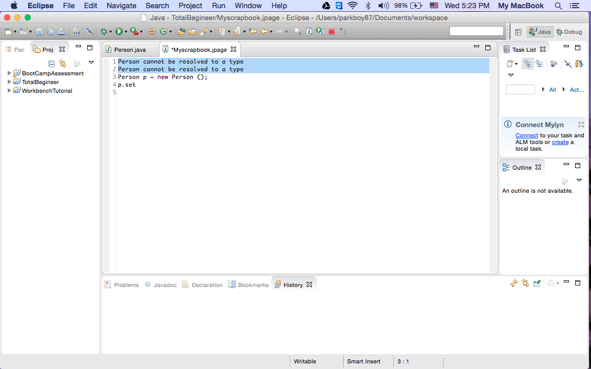

index.php/fa/19949/0/I'm new to eclipse and am working on a scrapbook file. When I highlight the code and hit inspect I get the error, "Person cannot be resolved to a type". In searching for solutions I come across suggestions about pointing eclipse away from Ant. I have no idea what exactly that means especially on a Mac. Can anyone shed some light on this?
Re: New Mac Eclipse user [message #1480049 is a reply to message #1480035] Wed, 19 November 2014 18:44 Go to previous messageGo to next message
Is "Person" the fully qualified class name? Is it in the same project, or a place configured in the Java Build Path page in that project's Properties dialog?

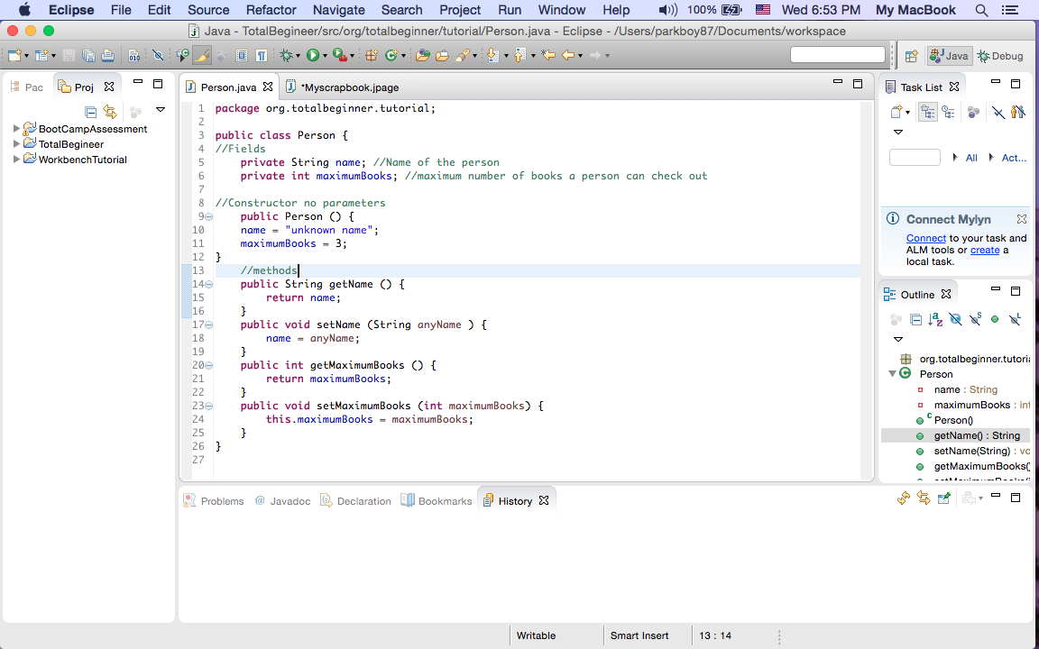

Re: New Mac Eclipse user [message #1480111 is a reply to message #1480049] Wed, 19 November 2014 19:57 Go to previous messageGo to next message
index.php/fa/19950/0/
I do believe it is the class name of this attached file. Is it in the same project? That I'm not sure of since I was under the assumption that using scrapbook did not require proper linking to a class.

Re: New Mac Eclipse user [message #1480833 is a reply to message #1480111] Thu, 20 November 2014 09:19 Go to previous messageGo to next message
A scrapbook has a classpath, which includes everything in the project that contains it, but no import statements by default (you can set imports for a scrapbook by right-clicking in it and choosing the Imports... option from the pop-up menu).
If Person is in the same project as your scrapbook then Person is already on the scrapbook's classpath but you still must use the fully qualified name of the classes you use in the scrapbook (unless you add them to the imports list). Ctrl+Space does work in scrapbooks, so just put your cursor on Person and use Ctrl+Space to auto-complete the full name.
Re: New Mac Eclipse user [message #1482242 is a reply to message #1480833] Fri, 21 November 2014 11:05 Go to previous messageGo to next message
I tried both methods which ended up solving the error. Thanks for the feedback and patience.
