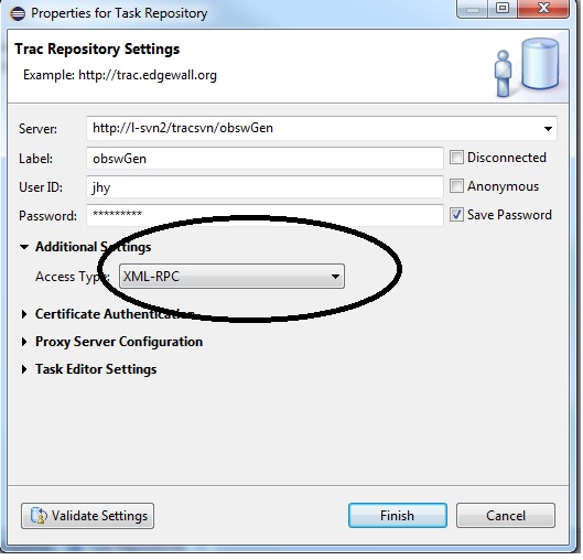

I'm trying to setup mylyn queries by using Oomph (which is very nice and a very useful) and I can't set in my *.setup file the access type of the trac connector for my trac repository (see attached picture).

Is there a special annotation to specify the Access Type to XML-RPC ?

Actually, everything works perfectly except that the setting XML RPC is not selected (see my picture). Mylyn accesses tickets via the generic web browser of eclipse instead of using the the appropriate view of mylyn tickets.
Probably that the issue is on the repository side i.e. XML-RPC shall be the default protocol.
However, it would be very nice to specify in Oomph which protocol is used !
